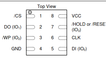

alright, but this is really not a great experience, more because I don’t have proficiency in manually rewriting bios [this work]. I used the pencil method that is circulating more as an “give me unlocked chromebook” sort of exploit, and it involves shorting 5V and WP to disable (and to do so again to enable), but I left it in disable and used it to install the ROM. The device is still set to enable, so could this do anything? Is there a chance that I can leverage this somehow to reflash without opening case [OR] Using a SuzyQ?
…you used the pencil method? Was your chromebook a managed device..? Pencil method was only a last resort option shown as a very risky way to disabling write protection if all other exploits to unenroll didn’t work.
Well ****, that means that a short in your board is not out of the question. Which diagram or guide did you follow to short the pins out? You weren’t supposed to leave the connection in, you were only supposed to short the pins out temporarily to disable WP, then immediately take it out.
Plus, you can easily disable write protection while in developer mode assuming your device is not a managed chromebook, it ties write protection to the battery sense line. I can confirm this works as I have had your specific device.
no, my chromebook was NOT a managed device. This is a very common question asked by many when i mention this. I believe that a short might still be out of question, because I don’t remember seeing any ‘magic smoke,’ and the device was successfully rid of WP. I did already tell that I shorted the VCC (Pin8) –> WP (Pin 3) line for 5 seconds allowing the sh1mmer exploit to take control of the rest of the WP disable, I believe.
I did this 1-2years back, and I don’t believe that this can come back to me.
exact pic
I will also note that i was seeing this shortly after I ran windows 11 on it, as I was using Windows 10 up to November (after it ended) and the device was very trustworthy.
The images appear to be recent, great. It means you didn’t follow the (incorrect) method where it was believed bridging WP/pin 3 with Ground (pin 4) would work.
