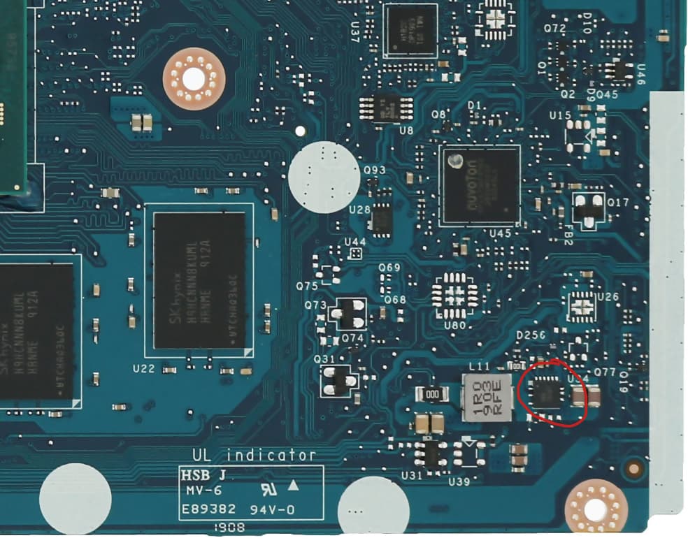

One thing you can do w/o a multimeter is check this chip - if it gets really hot then its a bad security chip or embedded controller, which are both BGA chips and difficult to replace
