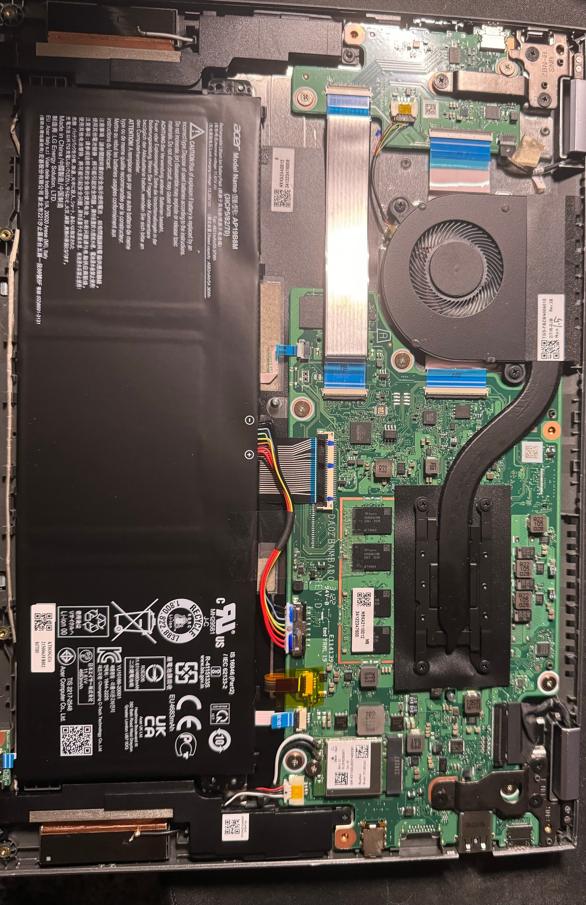

CP514-3H, help finding the jumpers to bridge
also when bridging the connection does it need to be soldered or can I just short the connection.

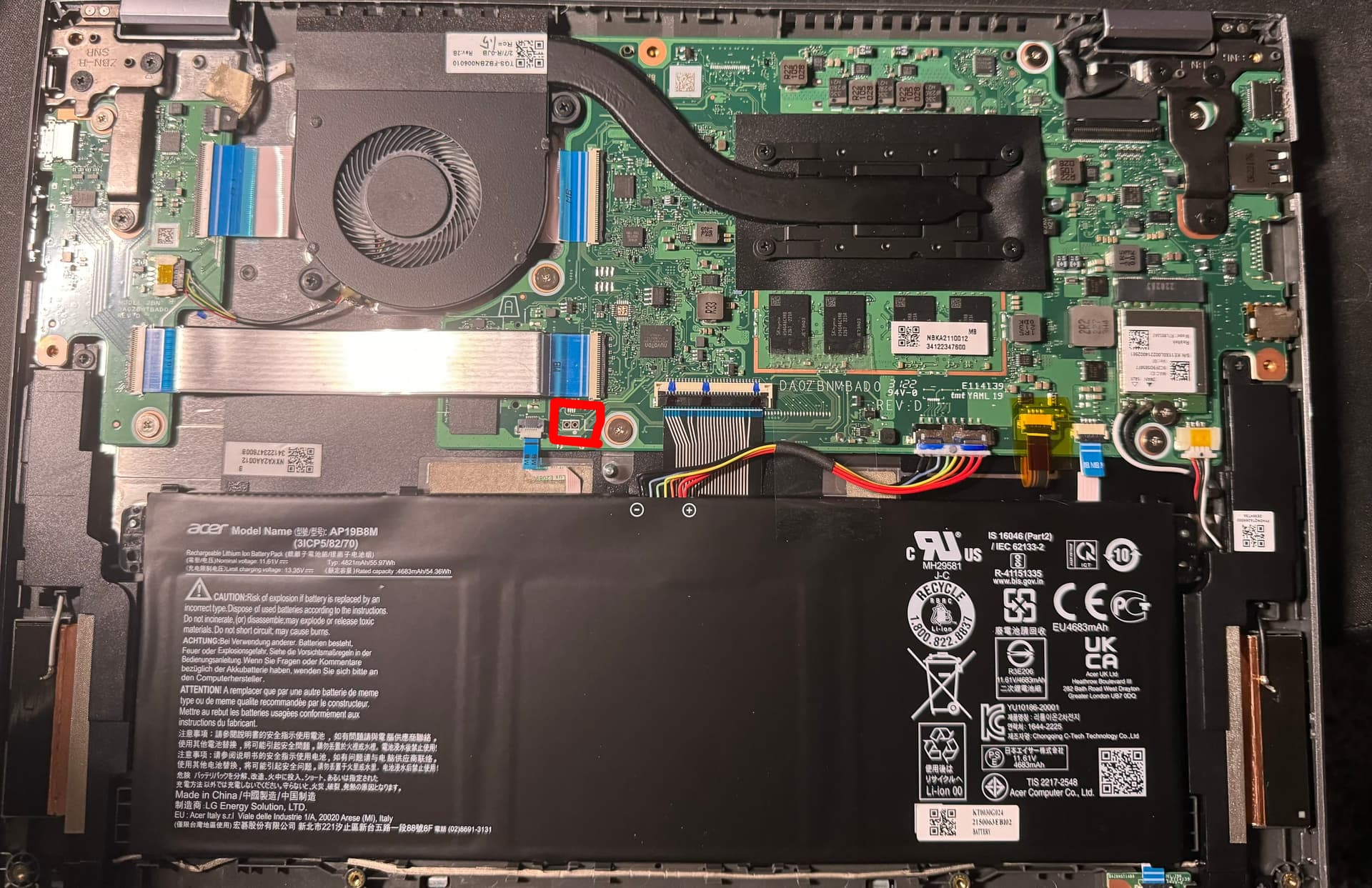

I believe this is the jumper for your device (Circled in red)
You only need to short the connection long enough for firmware write-protect to be turned off.
