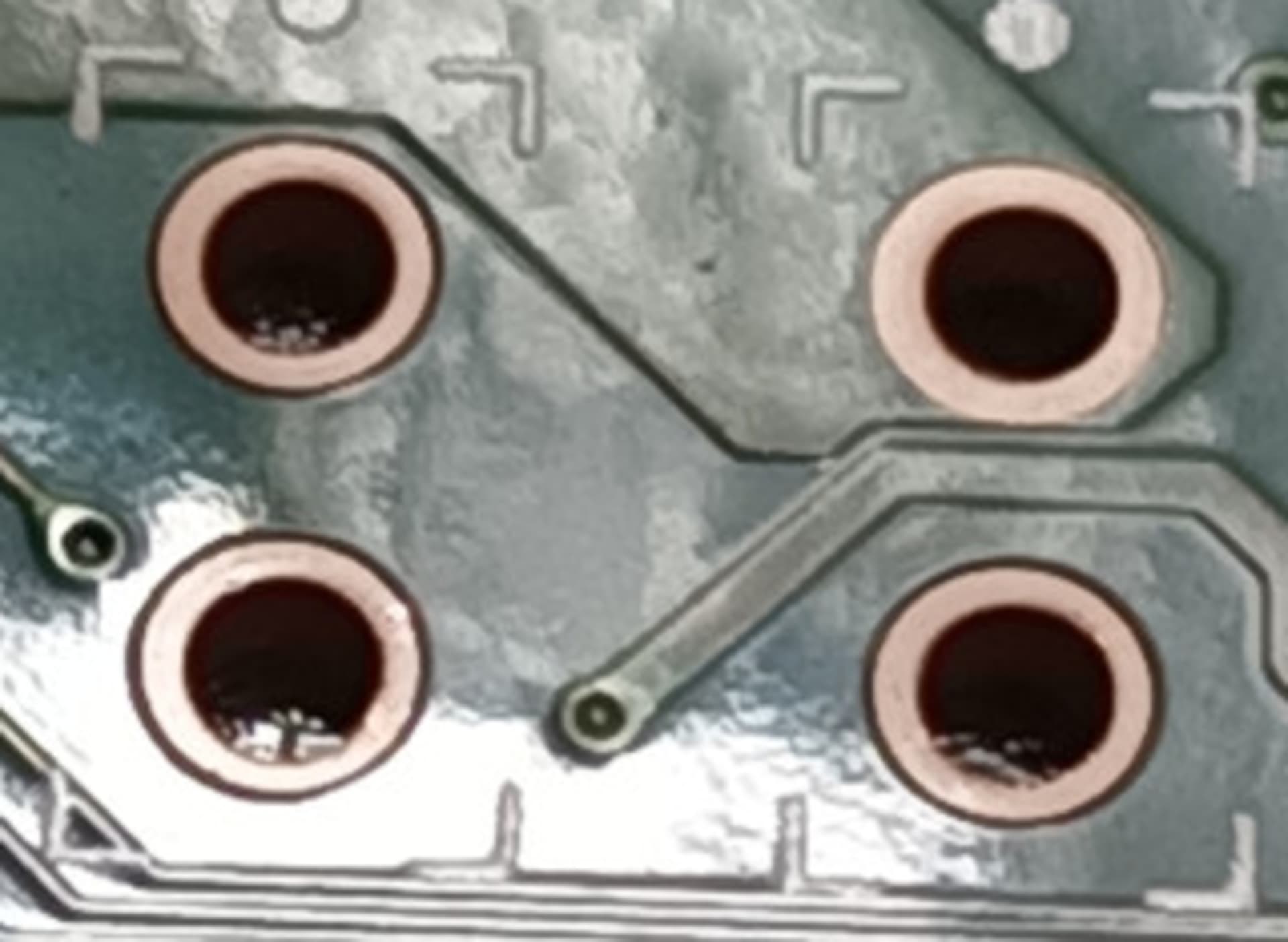

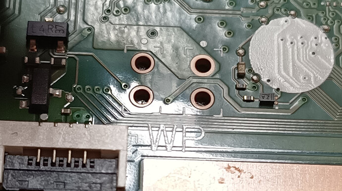

Copule WP jumpers on LANDRID dedede board
Ths year I bought an HP Chromebook with firmware write protection.
dedede board (Landrid)
In the photo attached you can see the holes.
Can you help me how to correctly jump the holes to correctly remove Write Protect?
Thank you so much in advance
connect the upper/lower holes on the right using a paperclip or solder

I consider myself fairly diligent but have only found you to be reliable on information for this particular model without a wp screw or s/w solve. I was given this HP 10e as a gift and very quickly found in its default {OS} state to be as useful as an ashtray on a motorbike. I just have 2 fairly obvious (apologies) questions:
  1. Can I confirm with you that if we are looking at the 4 pins from top to bottom, left to right, you are saying that I bridge C+D?
  2. I’m assuming I make this a permanent bridge i.e. solder and isolate?

  1. yes.
  2. it doesn’t have to be - just needs to be disabled at boot for the script to disable software WP, after that it’s irrelevant unless you re-enable software WP

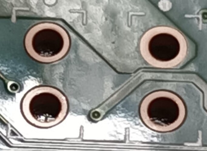

After reading Anwhelan’s post, I decided to disassemble my Chromebook with the Landrid board and try to rerun the firmware utility script. No luck. The WP message continues to remain red, and this is after short-circuiting as per your instructions, both running the PC with the battery DISCONNECTED and with the battery CONNECTED.
Out of curiosity, I measured, with a multimeter, the electrical resistance (in non-short-circuit conditions, that is, not-modified virgin circuit) between points A, B, C, D, and the long copper strip located at the bottom (which I will refer to as letter E).
Results of the resistance readings:
Resistance between one point and strip E:
A/E resistance off scale
B/E 0 ohm
C/E resistance off scale
D/E 99.3 kiloohm
Resistance between two points:
A/C 32.86 kiloohm
B/D 99.2 kiloohm
A/D resistance off scale
B/C 0 ohm
A/B resistance off scale
C/D resistance off scale
I don’t know if this data can be useful or completely useless, but I decided to share it anyway. OBVIOUSLY, the piece of metal with which I then performed the short circuit (2 different tests, aluminum foil and a metal wire) has a resistance of zero ohms.

If not, I will zap and flash…so to speak. And with that I will document carefully for our friend @mpatrick1985 if he hasn’t moved further yet. By the way to help, if you look at “hole” TR, you can see its clearly not isolated hence the black circle around the others. Look even closer you will see its touching the track at the bottom too.

I don’t have this board or the schematics for it, all I have is what others have reported working. AFAIK the correct way to disable WP on LANDRID is by connecting the two jumper holes on the right side.
