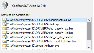

I purchased the “CoolStar SST Audio (AVS)” license. I installed the driver and need to sign a bin file… but in device details I have four bin files:
Which file should I choose to upload?
the readme tells you what file to upload, it’s not any of the driver files.

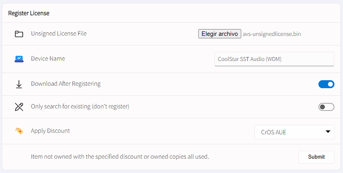

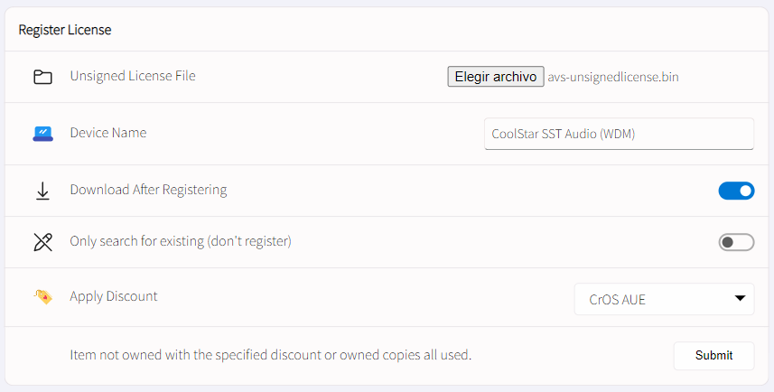

Ok … I ran the license generator to create the bin file… after uploading it, it gives me the following error…
Acer C732T
Intel Celeron N3350

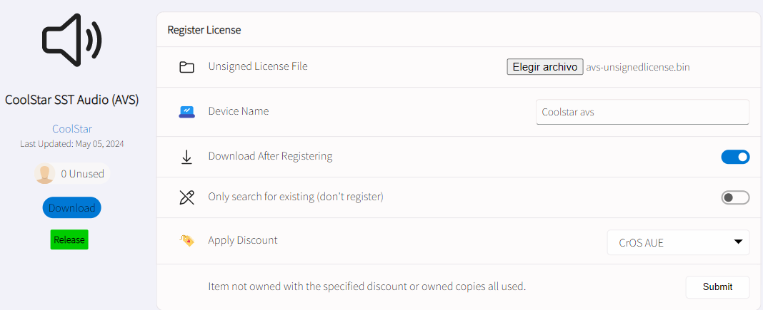

if I had to guess, you have a mismatch between the license and driver type, but your screen shot cuts off the part that shows the type (on the left)
it says you have zero licenses available to register
It’s strange, but I still had the $5 credit… then I bought a new license and the problem was solved… thank you very much
