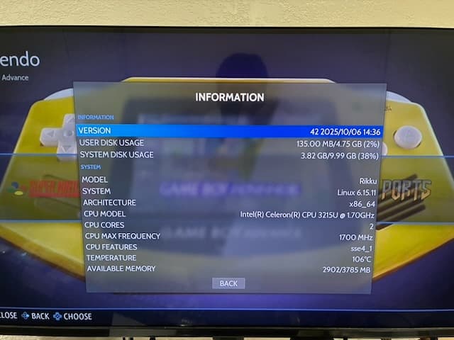

Thanks MrChromebox for your answer, and all your work. I was not running the latest firmware, and just updated it now. Batocera is now reporting 106C after updating firmware, rebooting, and going through the menus.
install lm-sensors package and then report what the sensors command shows. There’s a Linux bug for reading the PCH temp on Haswell/Broadwell which would appear to be what is happening here
