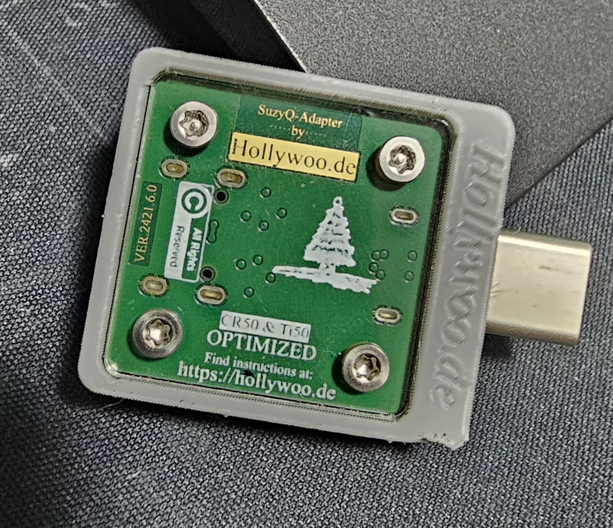

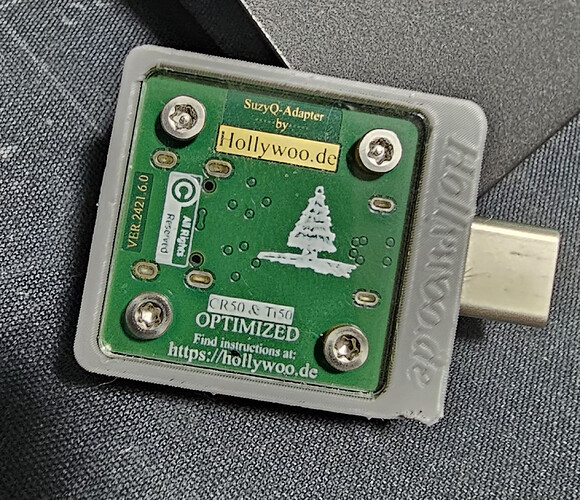

I’m (struggling) buying a SuzyQable to be able to flash a new UEFI rom.
Hello,

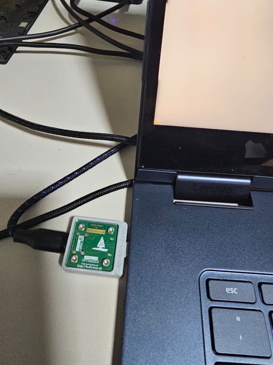

I bought a SuzyQable from China; eBay shipping to Brazil was very expensive.

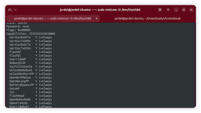

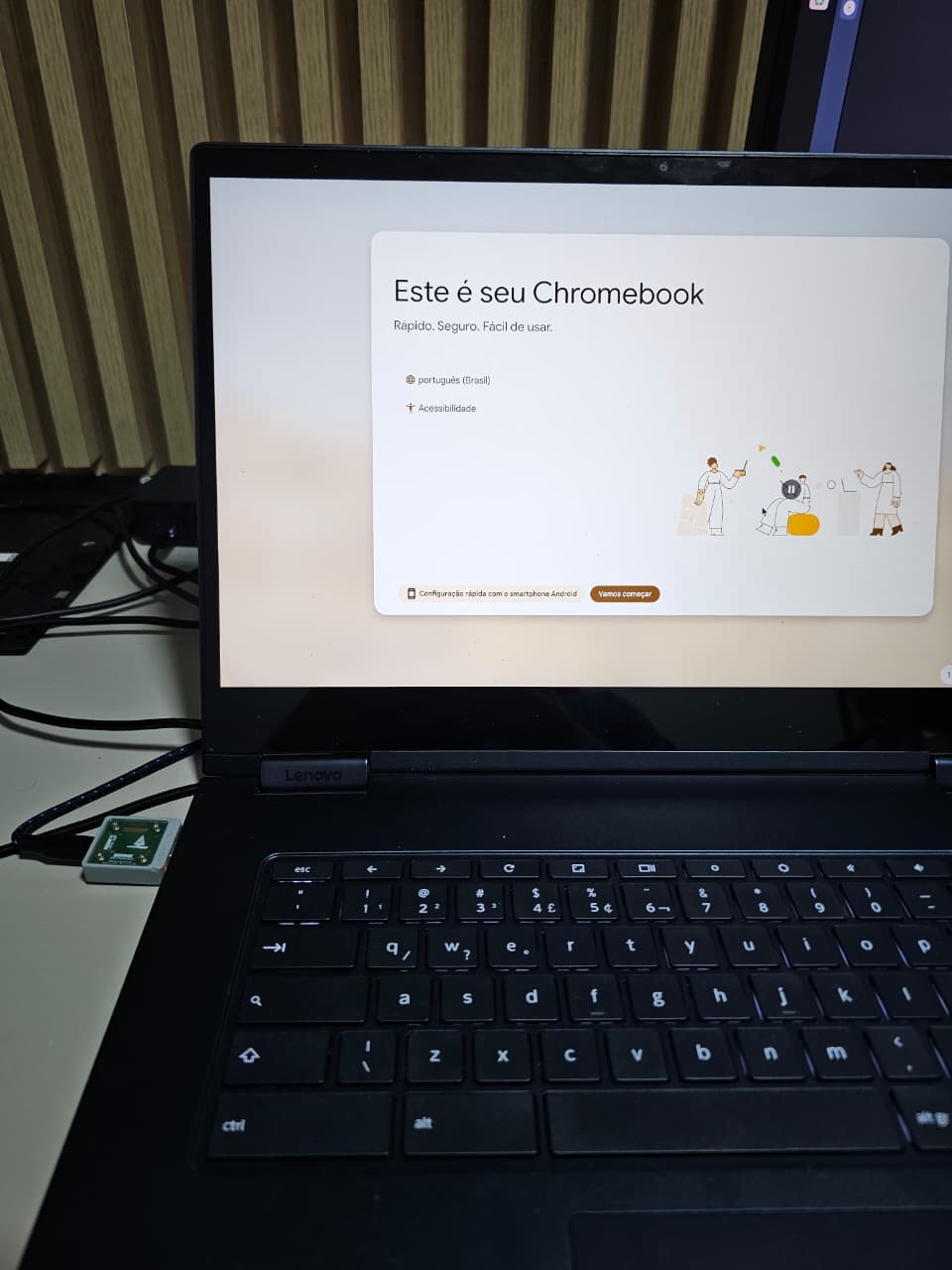

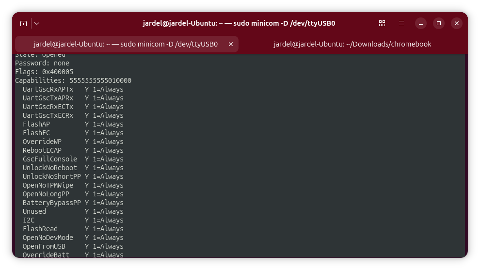

Using this adapter and my Ubuntu system, I managed to reset the CCD to factory settings, so my Chromebook started booting normally again.
All I had to do was disconnect the battery from my Lenovo C630 and use minicom to run the commands:
‘ccd open’
‘ccd reset factory’
I also enabled TestLab:
ccd testlab enabled
