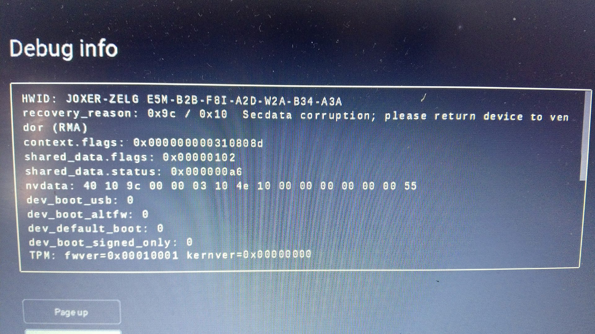

Cant Start cause TPM initializatin Error 0x5d
you’ve given us no context whatsoever. What is the current device state, and how did you get there?
Sorry, my English ist Not the Best.
I’ ll try to use Windows on this Chromebook but “surprise” Sound and Touchpad doesnt work right.
I think i forgot to reset the gbb Flags or Something Like that but
make a recoveer Power wash…
Now the Chromebook start wit an Error.

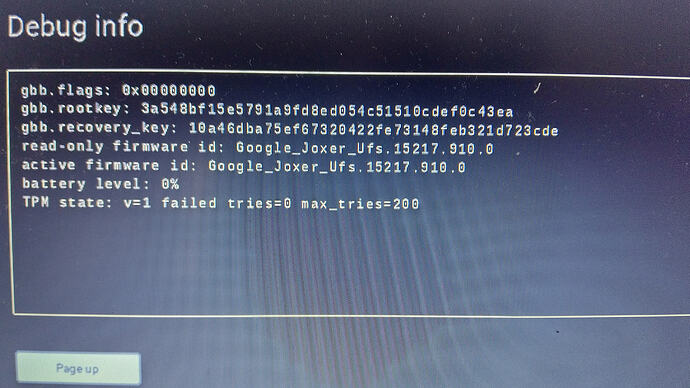

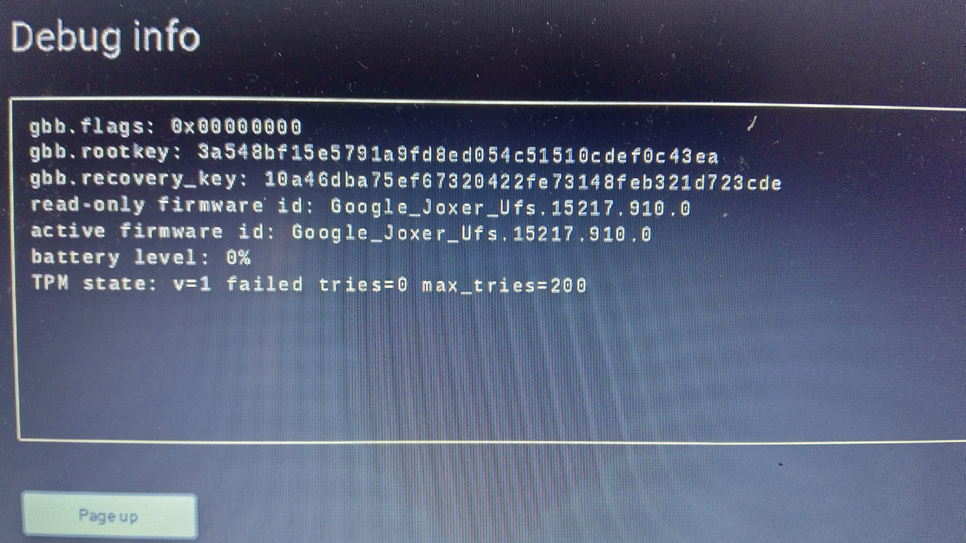

you didn’t do anything wrong. you’re not supposed to touch the GBB flags. Your screenshot shows they are correctly set to 0x0.
You will likely need a SuzyQ cable to recover
