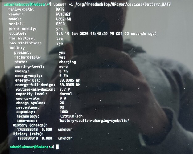

So…I ended up using flashrom in MX Linux and it worked after 3 failed flashes using the original ch341 programmer. I installed Fedora, but the problem I’m having now is the led blinking orange and charging the battery. upower output is attached. The battery hasn’t been charged in 4 years.
looks like a bad battery to me, but maybe just needs to charge for a while with the device off. Flashing battery LED usually means a battery error or no battery detected
