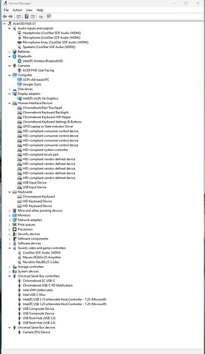

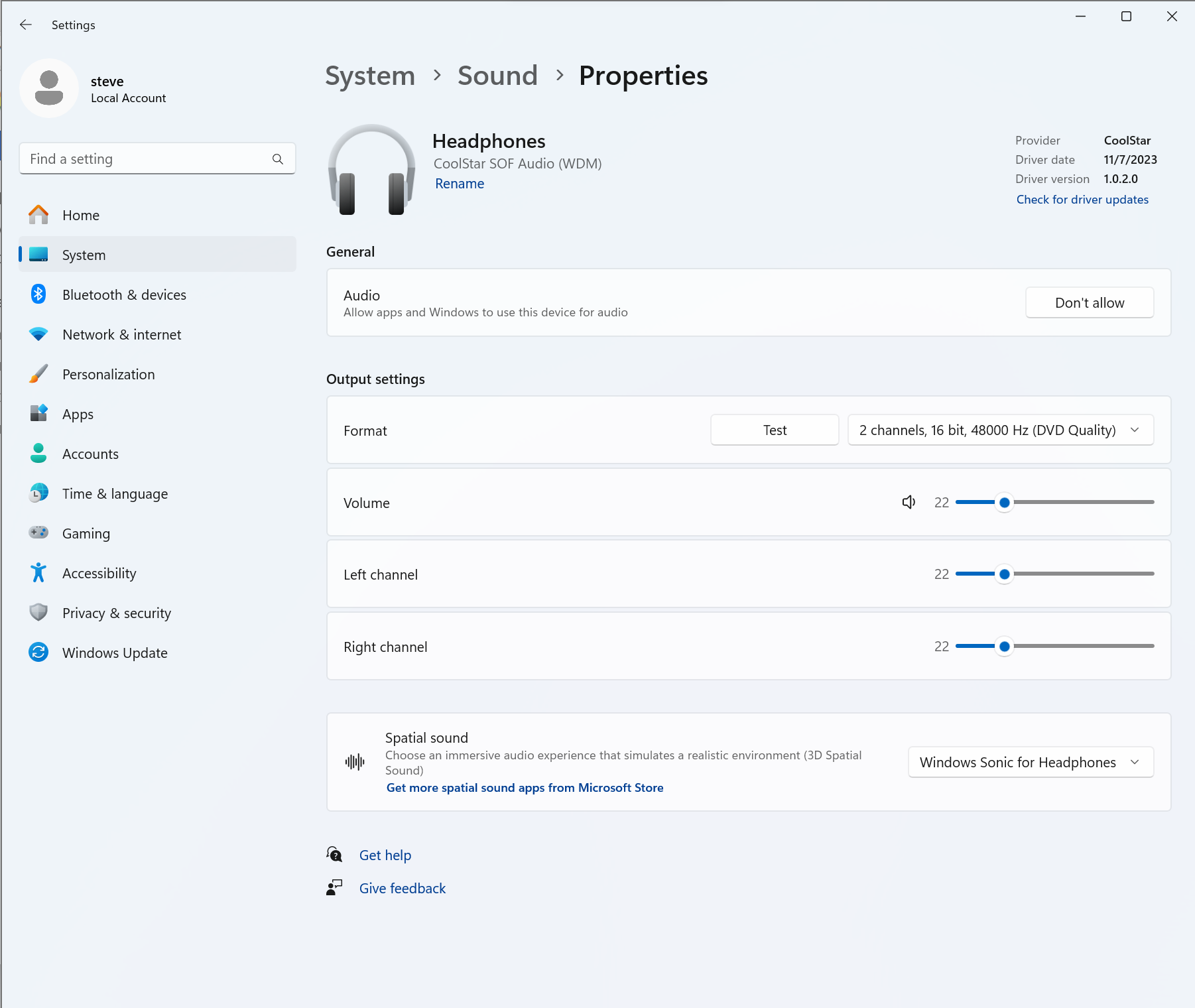

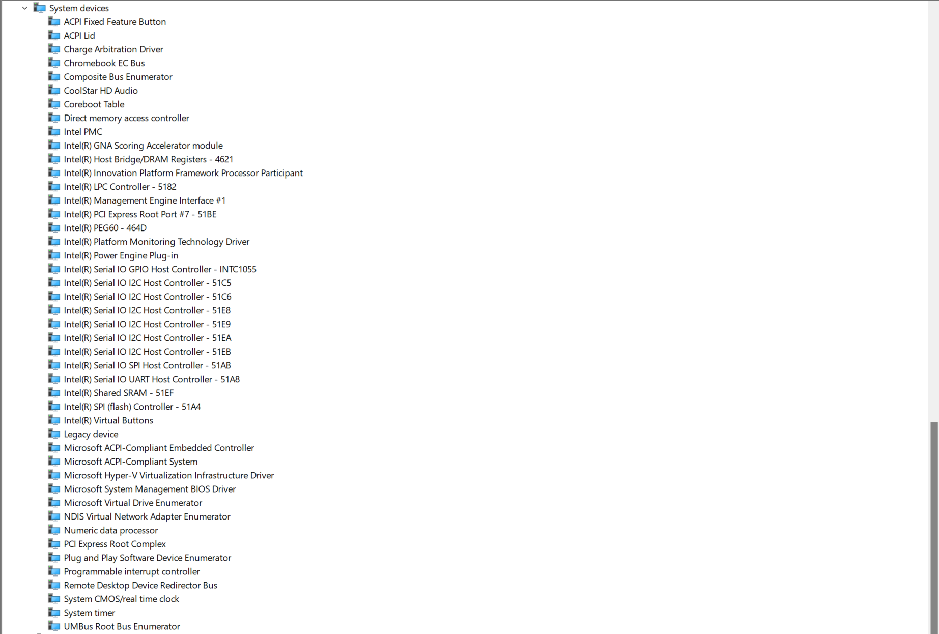

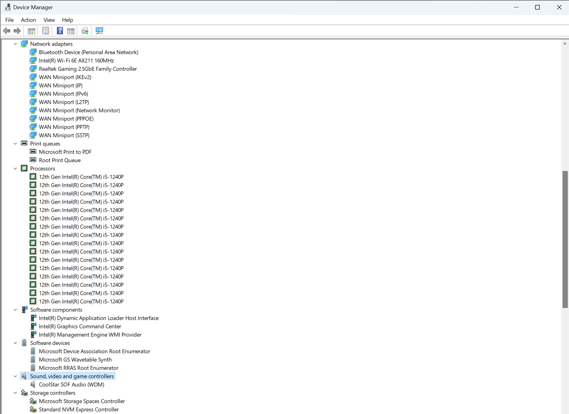

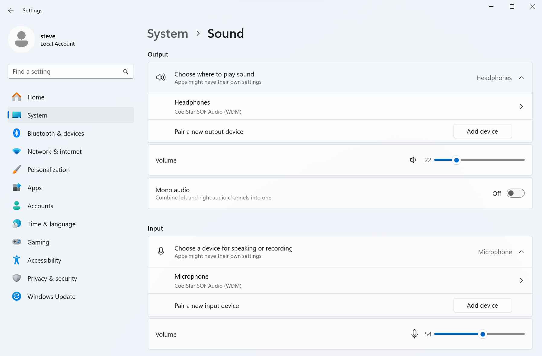

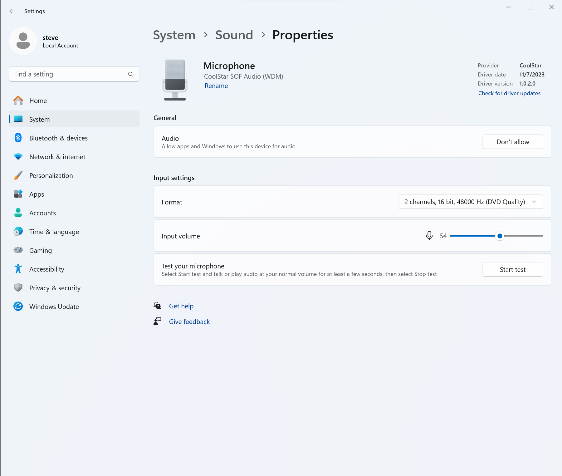

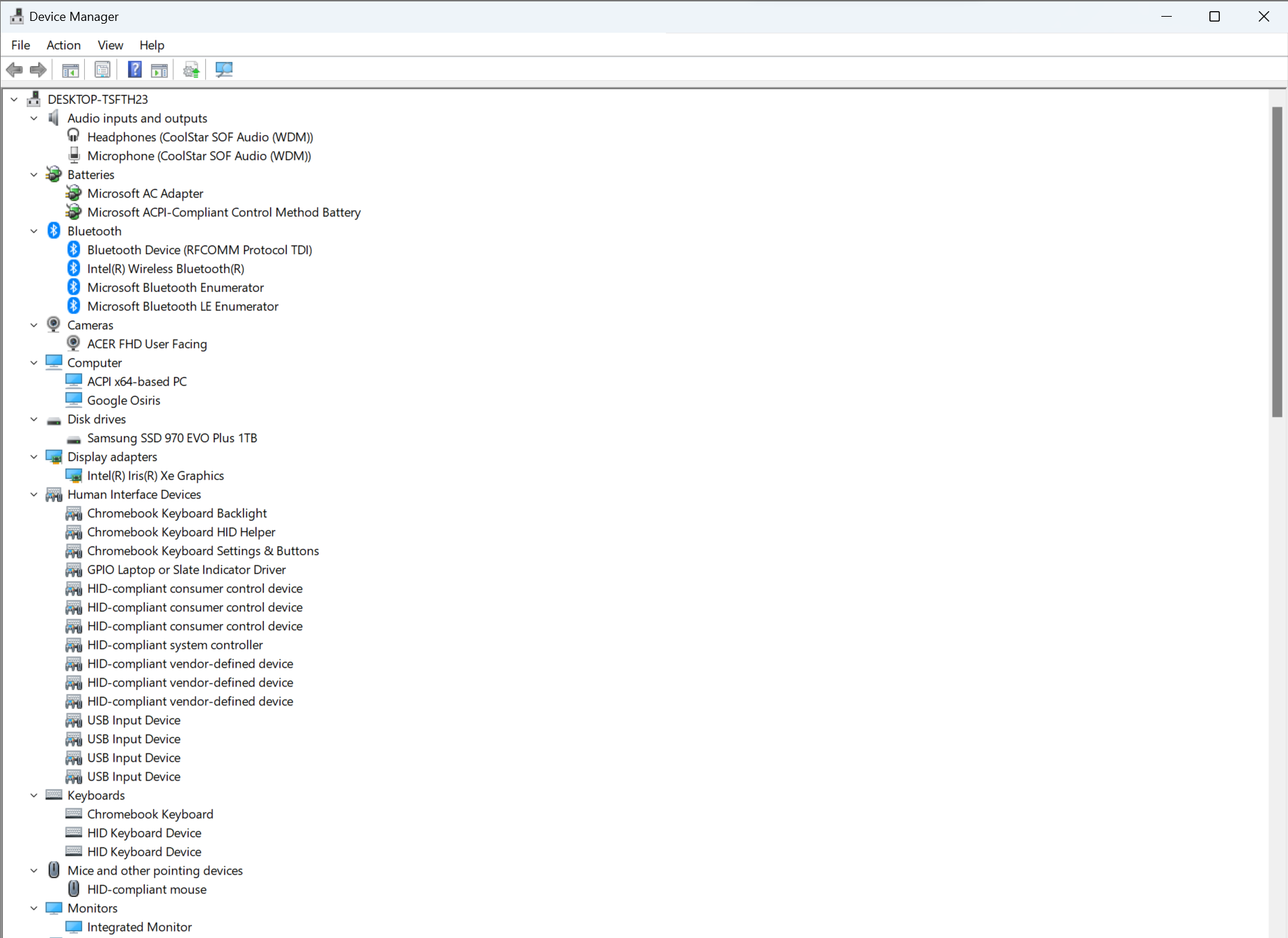

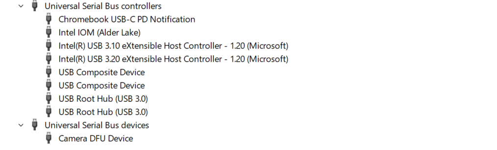

I’ve attempted to dump the entire device tree as a series of images. At the bottom is also the audio settings. I cannot select any other audio devices (there is no internal speaker option or headset mic option). If I plug in a headset, nothing changes. I get no sound from either the internal speakers or a headset.

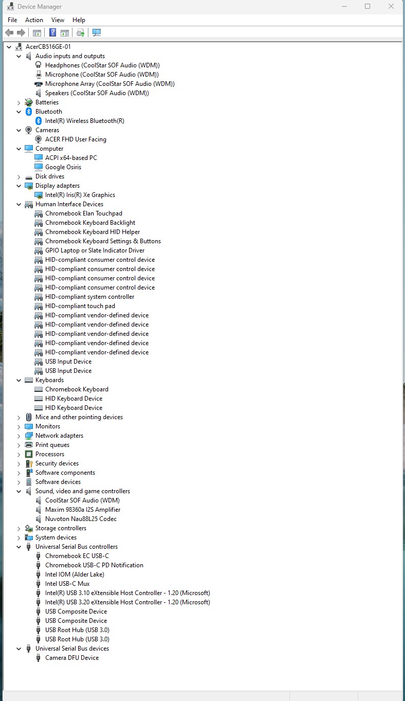

Here my Osiris Device Manager (Win11)
I expanded what looked different between ours

So the underlying physical hardware is functioning. I don’t know why windows did not install the various drivers that you have but I do not? I see that I am missing the Intel USB-C Mux, the microphone array, the speakers, the elan touchpad, and hid compliant touchpad.
And even though I have the sof audio, headset and headset mic devices, I don’t get any audio over a headset.

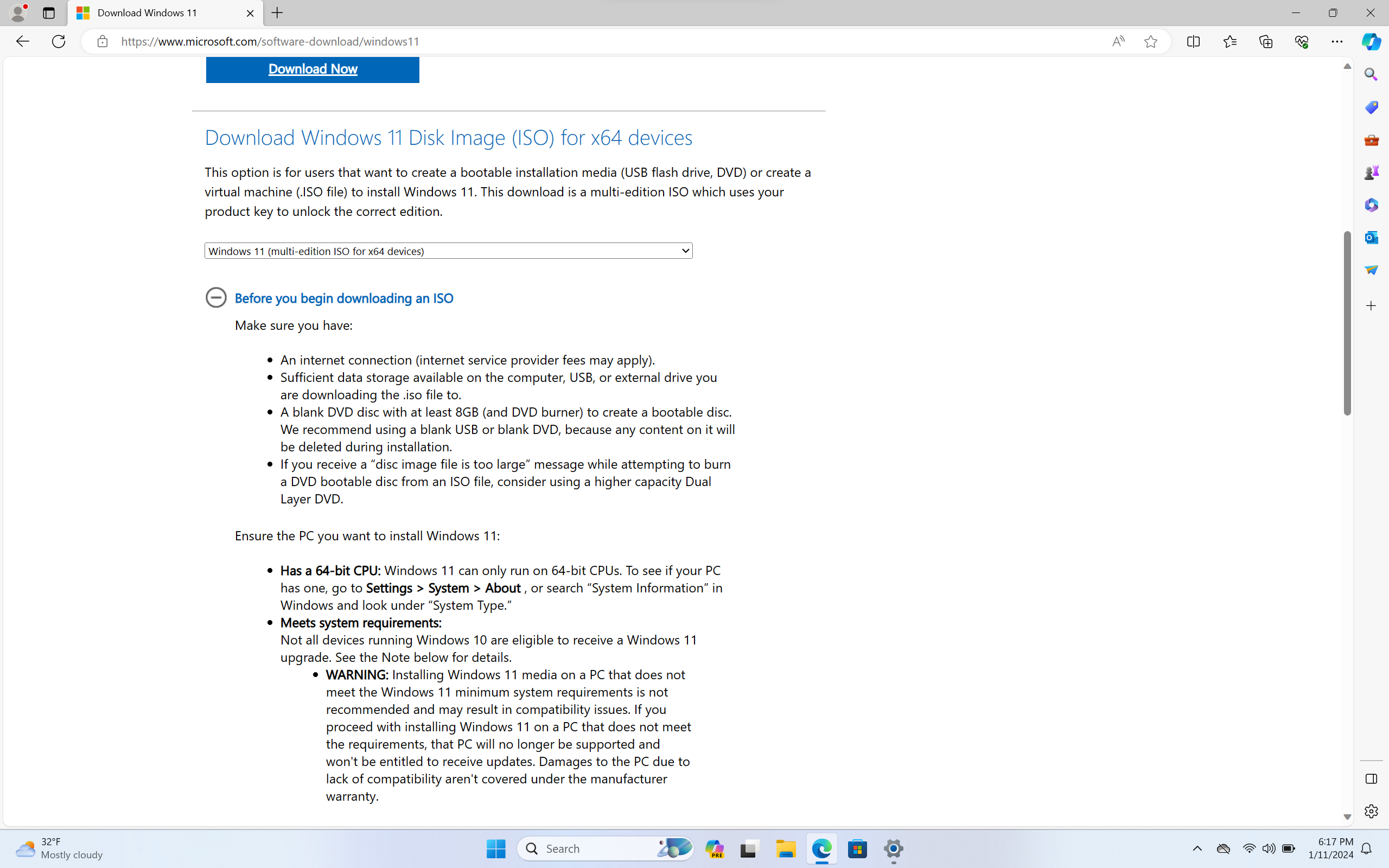

And you’re using an official MS downloaded ISO? not some customized one or anything.
I dont know if matters but i am on Win11 23H2 Enterprise
I got the windows install media from microsoft. Attached is an image of the page I used. I used rufus to flash it to a usb. I used the rufus options to disable tpm, secure boot, and to create a local user. It is windows 11 home edition. This is what I have a license/windows key for.

I noticed that the usbc ports are working with windows, but only if the device is plugged in before I boot.
