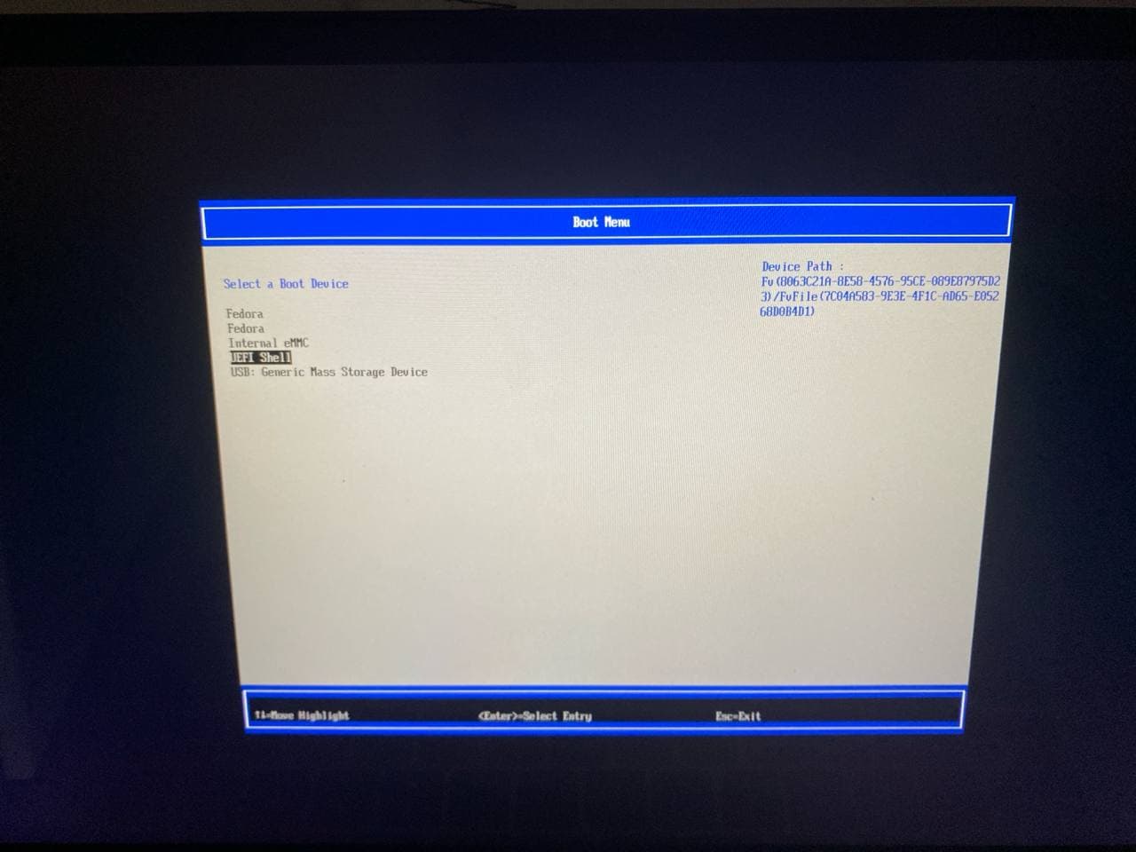

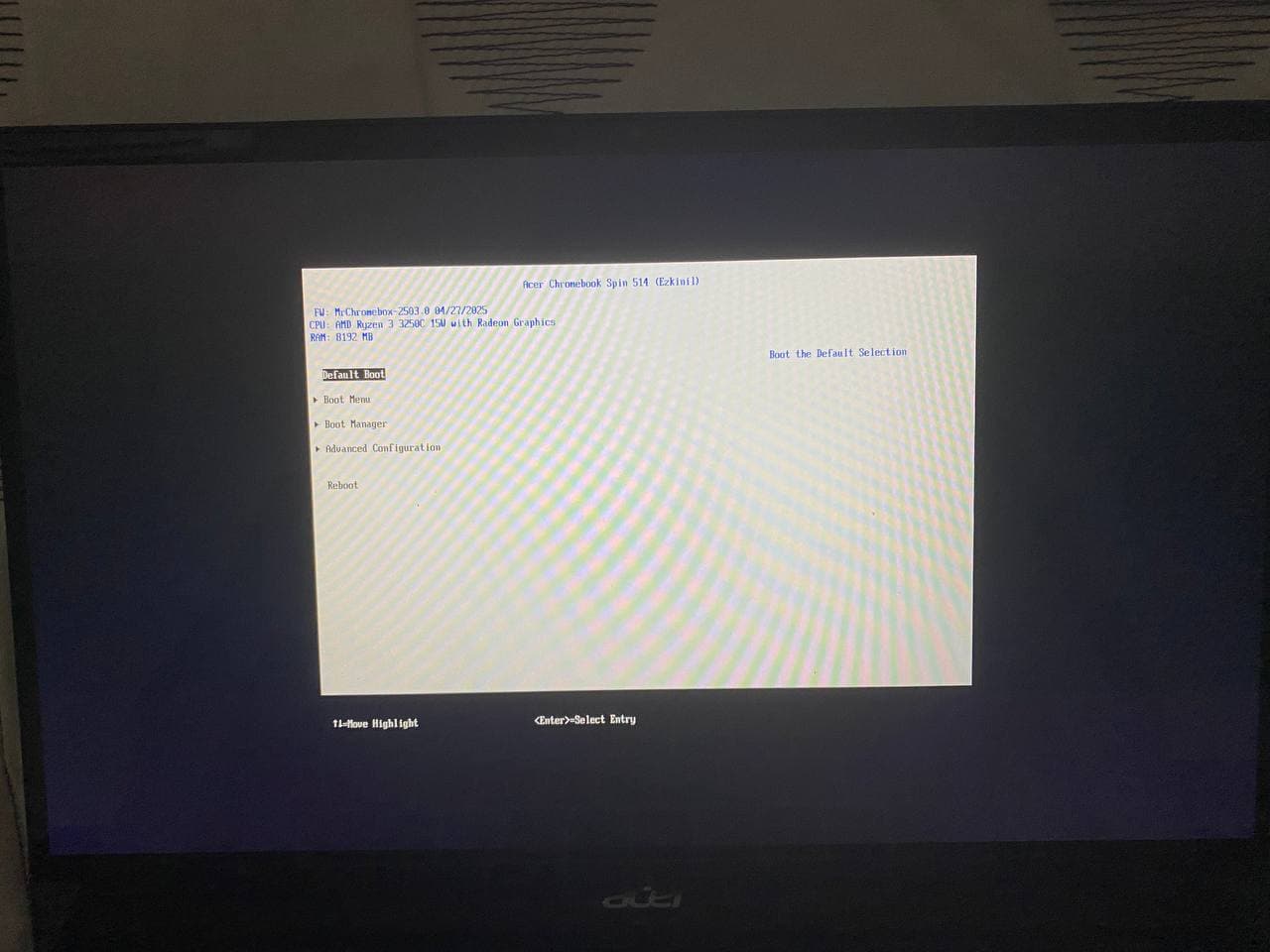

Flashed the full rom using mrchromebox’s script, rebooted into my existing Fedora install (I was on rw_legacy with chromeOS dualbooted before flashing) and everything worked fine, I ran the script again to check how the update process was and it flashed fine once again, but after rebooting this time it stopped working and now I’m stuck. edk2 posts fine, I can get into options and even get into grub/systemd-boot, but once I try actually booting an OS (and I tried arch iso, fedora 42 live, ubuntu 25.04, memtest, none worked) the machine takes a few seconds and then just reboots back to edk2 again.
