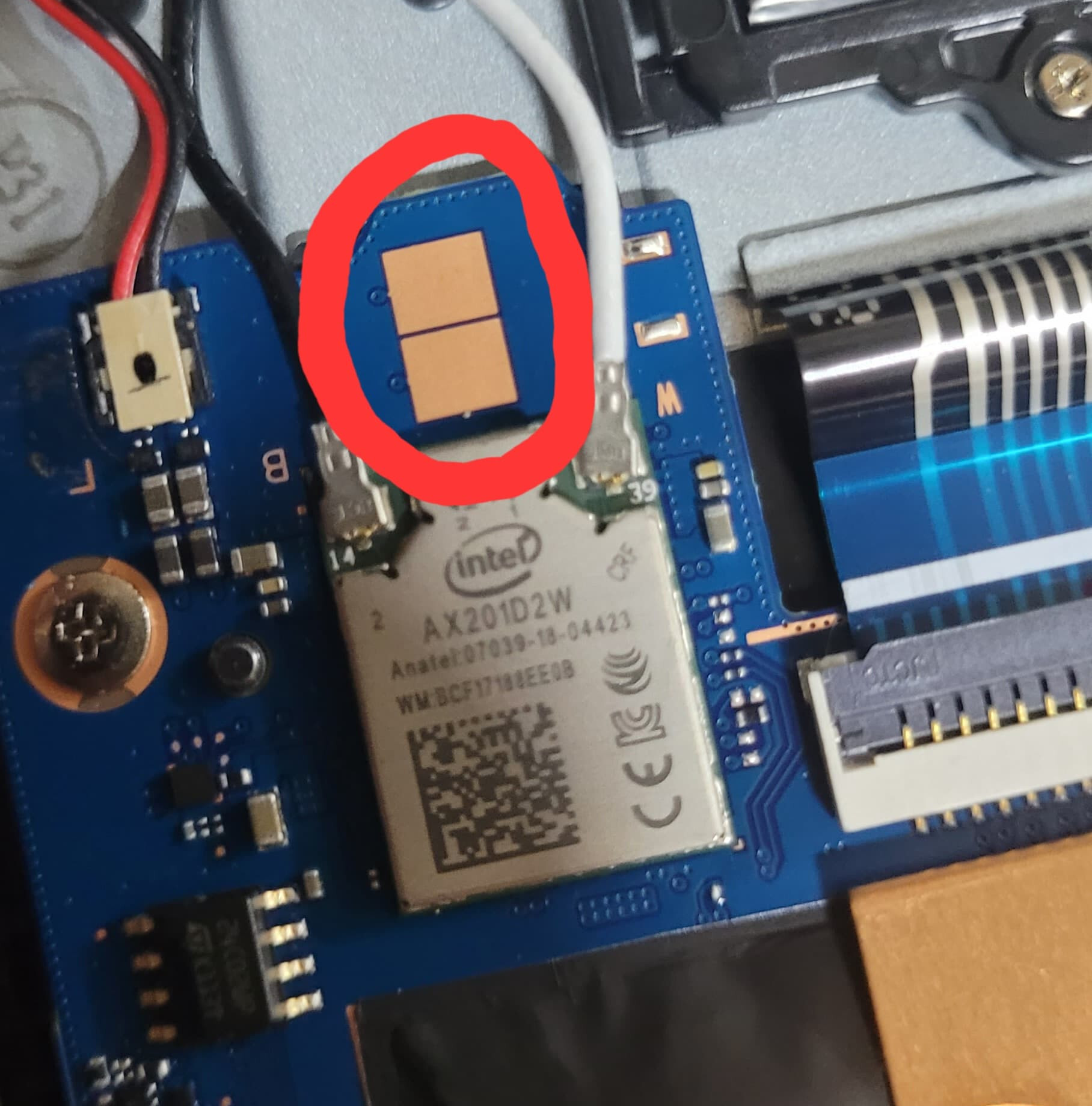

shorting these 2 pins just shuts off my chromebook, booting it back up and checking wp status it still shows enabled. jumping them while the chromebook is off will make it turn on after sometime, but i get the same results. do i need a suzyq cable in order to disable wp?
You may need to boot the device without the battery connected to the motherboard. I kept the charger plugged in while leaving the battery disconnected, and that worked for me.
i’ve tried that, are you referring to battery wp in general or specifically for this model?
i thought it had a battery wp at first, so i had it undone when i later found out i had to jump those pins
Maybe try both?
Just giving ideas, I’m not an expert.
yea battery doesn’t make a difference unfortunately
Use a SuzyQ cable
