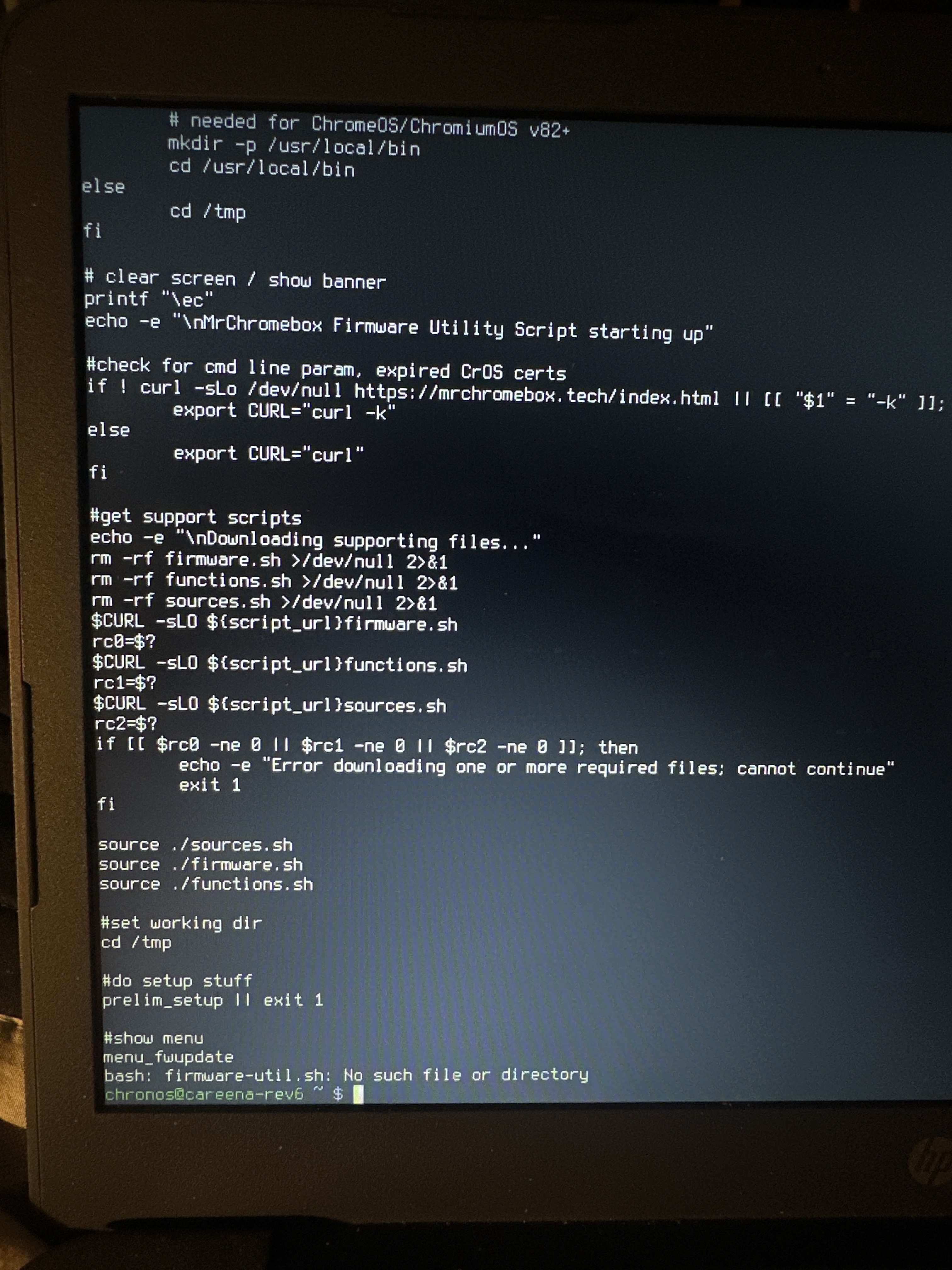

unplugged battery, typed in the chromebox utility code:
i’ve been met with this:
also, r.e when i got this, i was given it at some point in my school life circa 2017 onwards. i apologise for any inconsistency
never mind i put L0 instead of LO

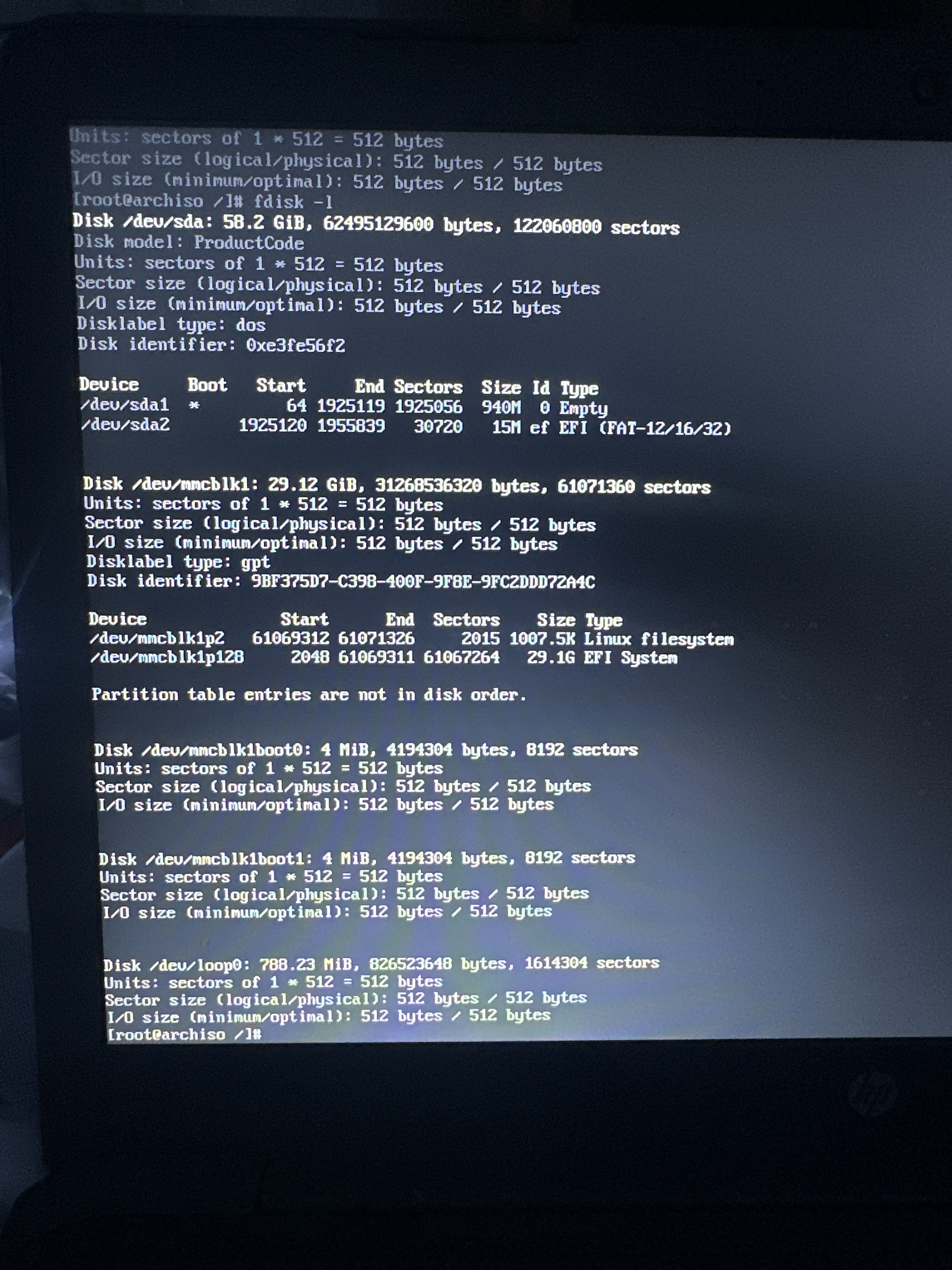

i’m 900% sure i messed up somewhere. here’s my fdisk list.

… How did you manage to do that???
Yeah, you’ve made your ESP 29.1GB and your root partition 1GB when it should be the other way around.
You can save some space by making your ESP even smaller.

should i reformat them or start a fresh install

Should i just completely start again? this time with less sleep deprivation?
If so, how on earth do i restart the process?
Or, do i reformat and repartition the drives?
Yeah just redo the partitioning
Yeah, insert a new flash drive with a recommended distro on it, and just do a fresh install
