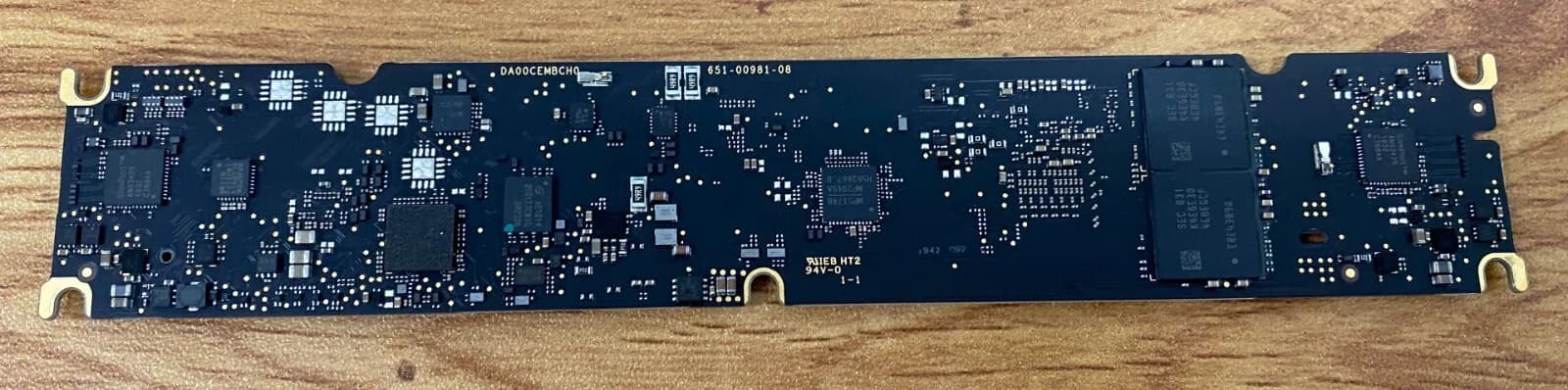

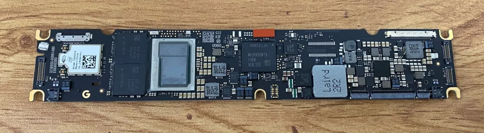

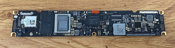

I found these photos but I cant identify where is the bios chip. Could you help me pointing it out? Thanks alot!
It has a i5-7Y57 Intel processor.
