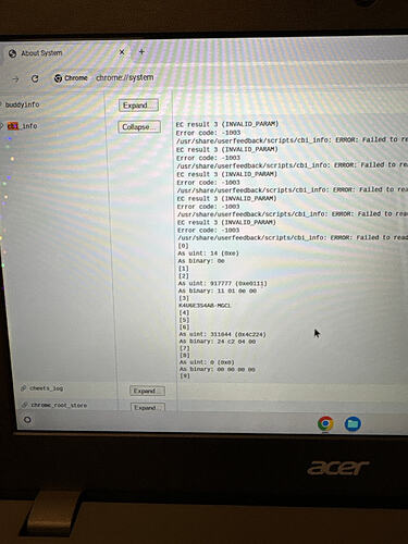

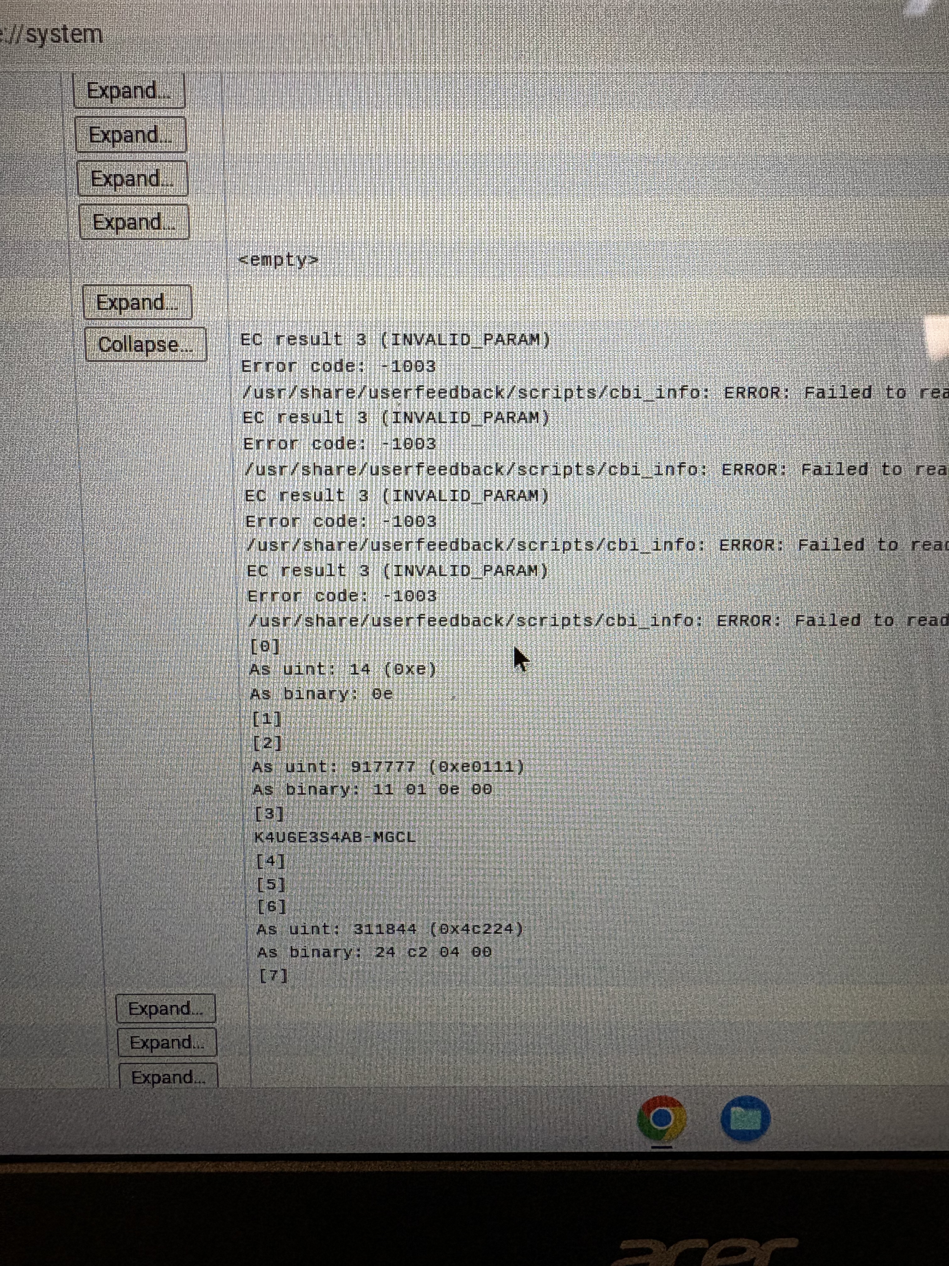

yeah I have cbi_info from chrome://system before and after running the code.
Before
After
what would be the right way to get touch working on this device?
I followed others and your advice on previous posts to get the touch working. Nothing about audio config was ever mentioned.
I don’t even know what device we are dealing with. what’s the board name? make/model are useless.
Dedede is the board name. maglith is the model.

from your pic above, SSFC was not set at all, so everything defaults to unprovisioned
