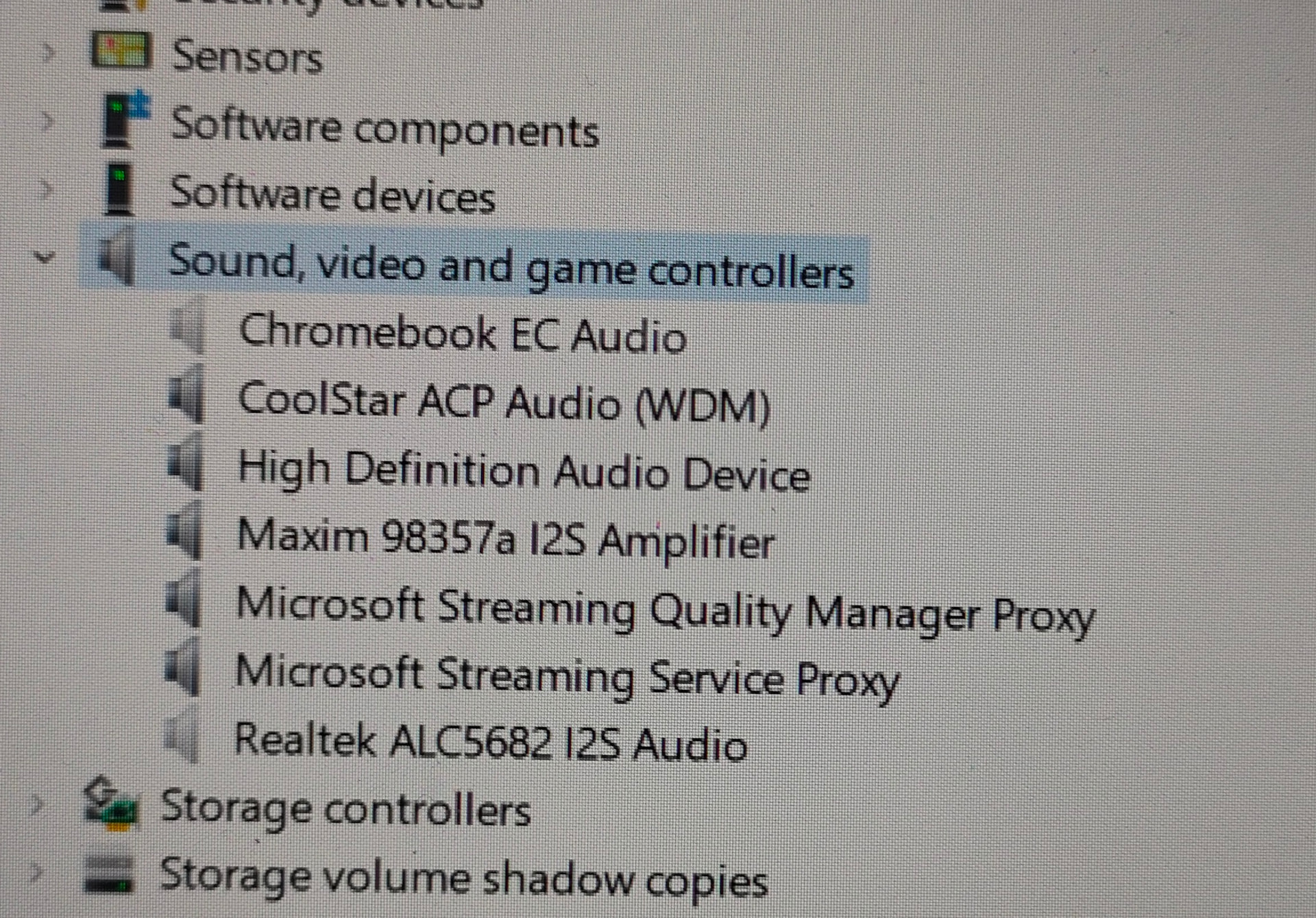

Hi,
I have a problem with Yoga C13 morphis, AMD Ryzen 7 3700C with Radeon Vega Mobile Gfx 2.30 GHz with audio driver. Whwn I install csaudioacp3x.1.0.4-installer.exe and select Speakers (Coolstar CP Audio (WDM)) I get slow motion video and slow motion audio…
(Audio Chip
High Definition (HD) Audio, Realtek® 5682I-CGT codec)

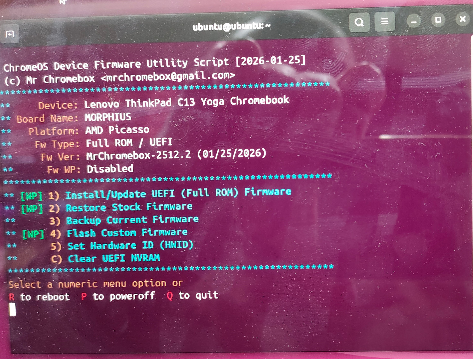

Ok Sir:
First ….i changed os chromebook for Lenovo C13 Yoga Gen 1 to windwows 10 after finished install all driver downloaded from coolstar org … all driver installed only audio driver installed but output not working …i try installed more copy of windows same same problem

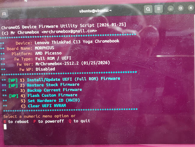

update your firmware to the release from yesterday
how can make this (( update your firmware to the release from yesterday
)) please give me idea.
run the script from Linux, as per the instructions on my site
please can talk with me live chat … bucasu i dont have information about make what you say
sorry, I don’t have time to walk people though basics like running the script.
you already did it once to flash the device, just do the same thing again from a Linux USB
i did it once to flash the device and same problem …plaese if you have this firmware.rom send to me for fix this issue please if possible.
sir you mean make downgrade virsion Firmware ??
no version should be dated yesterday
