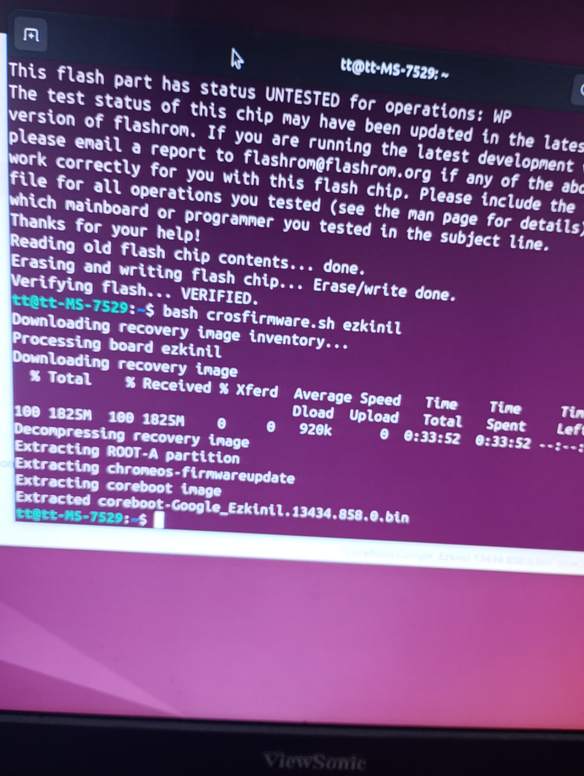

I flashed both with and ch341a with adapter 1.8V
The write protection is disabled (the battery is disconnected)
flashed with this firmware: “coreboot_edk2-ezkinil-mrchromebox_20240914.rom”

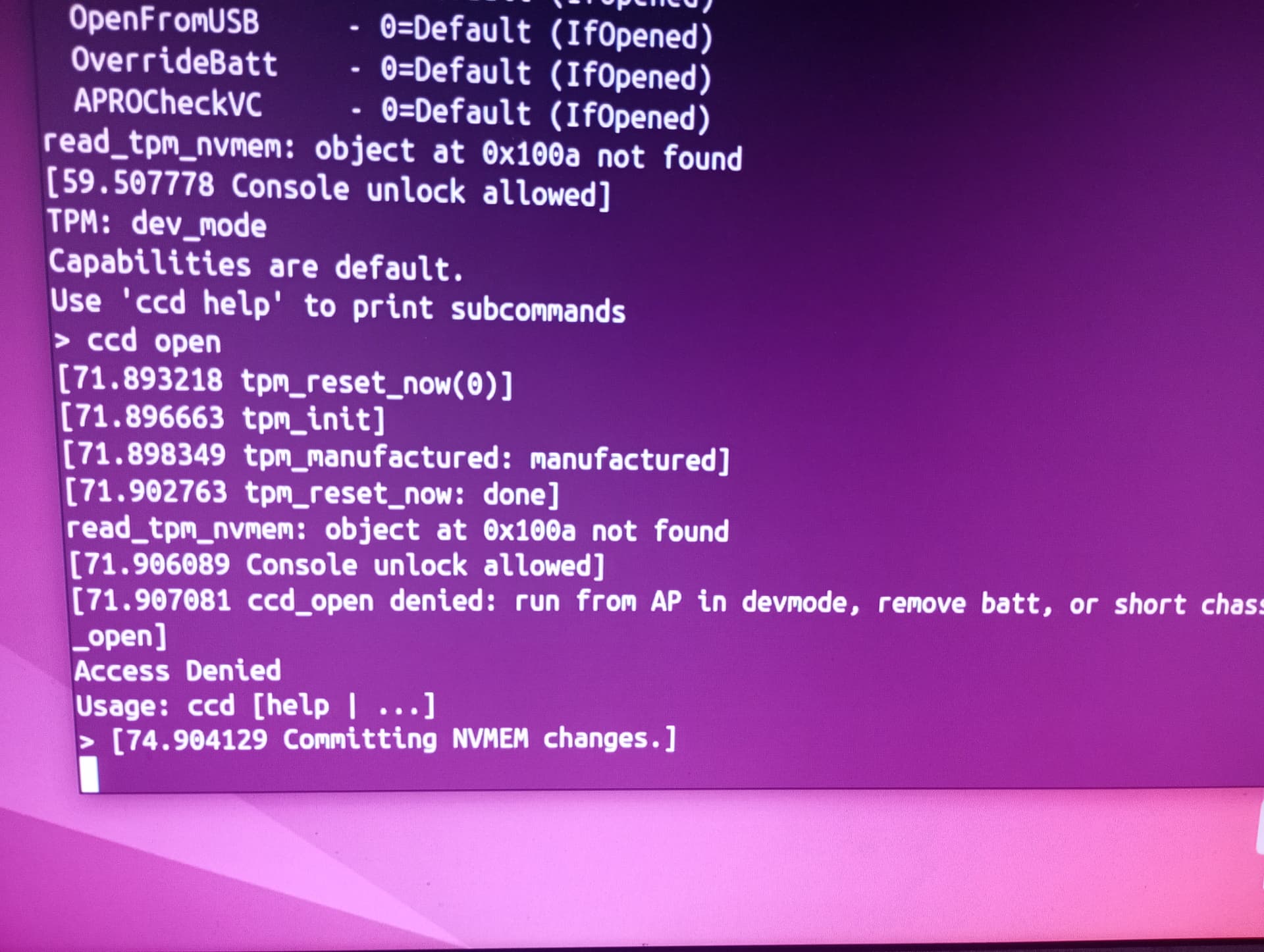

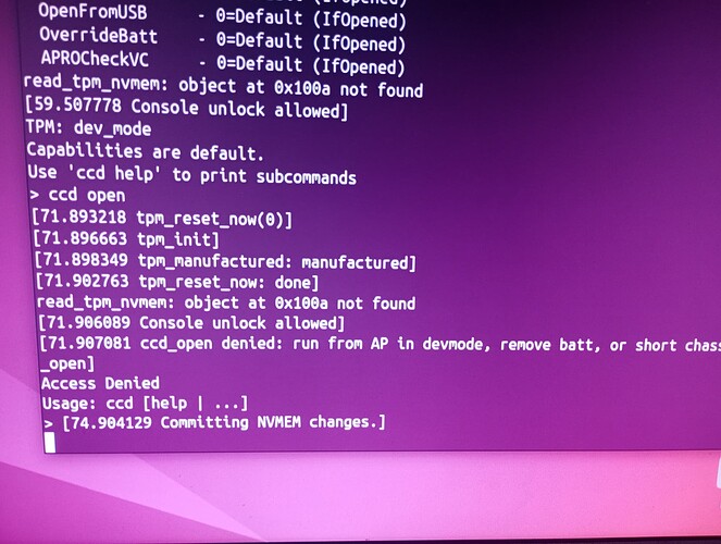

I connected Suzy Q, I display three tty0,1,2, outputs three tty0,1,2, but when I run sudo screen /dev/ttyUSB0 then ‘ccd open’ output Access Denied

device should be off and all power (including battery) disconnected
I flashed both with and ch341a again black screnn. what actions are still to be taken
Thank you. I did so, but the result is the same “output Access Denied”
go back to stock.

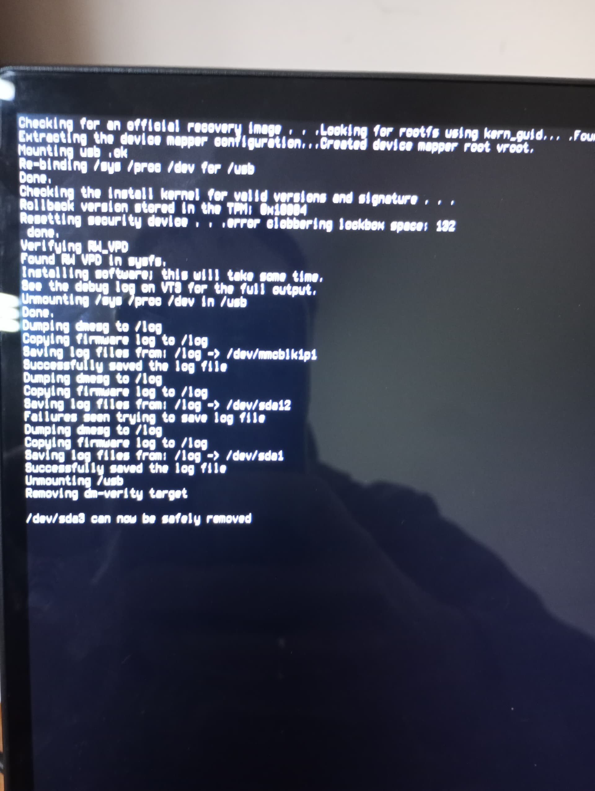

Thanks for helping. Before i flashed the bios, i recovery from usb flash drive. Recovery did not help. What does that mean “error clobbering lockbox space:132” and “VBNV: CMOS invalid , restoring from flash”?
no idea, I don’t know if that’s normal or not
