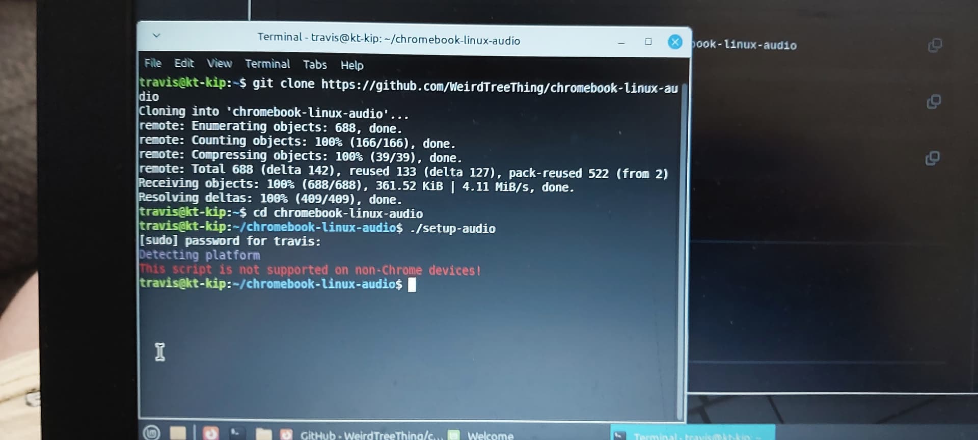

The audio script did not work for me, HP Chromebook 11 G4 KIP, is anyone have the script for baytrail, if so thanks

What error did you get when attempting to install the software?
I removed the board_vendor check as it was likely redundant anyways.
Are you using an LTS version of Linux Mint? Unfortunately these versions usually have problems with up-to-date audio codecs. If you are, use a Bluetooth audio speaker and we finish here. Otherwise tell me what version you’re using and I might recommend some options.

heres the file
debug-logs-kip-2025-05-04_21h27m.tar.gz
Use full rom firmware
does it not work on RW_LEGACY?
The system manufacturer is “Hewlett-Packard” on stock firmware, which breaks chromebook detection in my script. There is also no reason to use RW_LEGACY on EOL devices since it should only be used for dualbooting and ChromeOS doesn’t get updates anymore.
