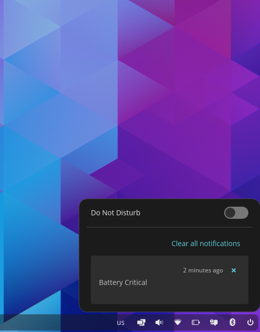

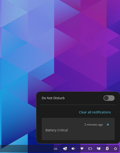

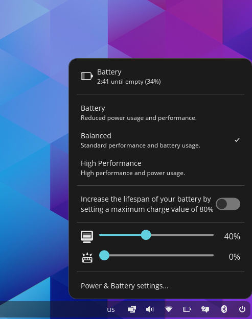

Right now while using pop os the battery critical error popped up again. as you can see from the screeshot battery is at 34 percentage. The warning sound remains till i reboot. not finding any related messages in dmesg, any other place to look for logs?
