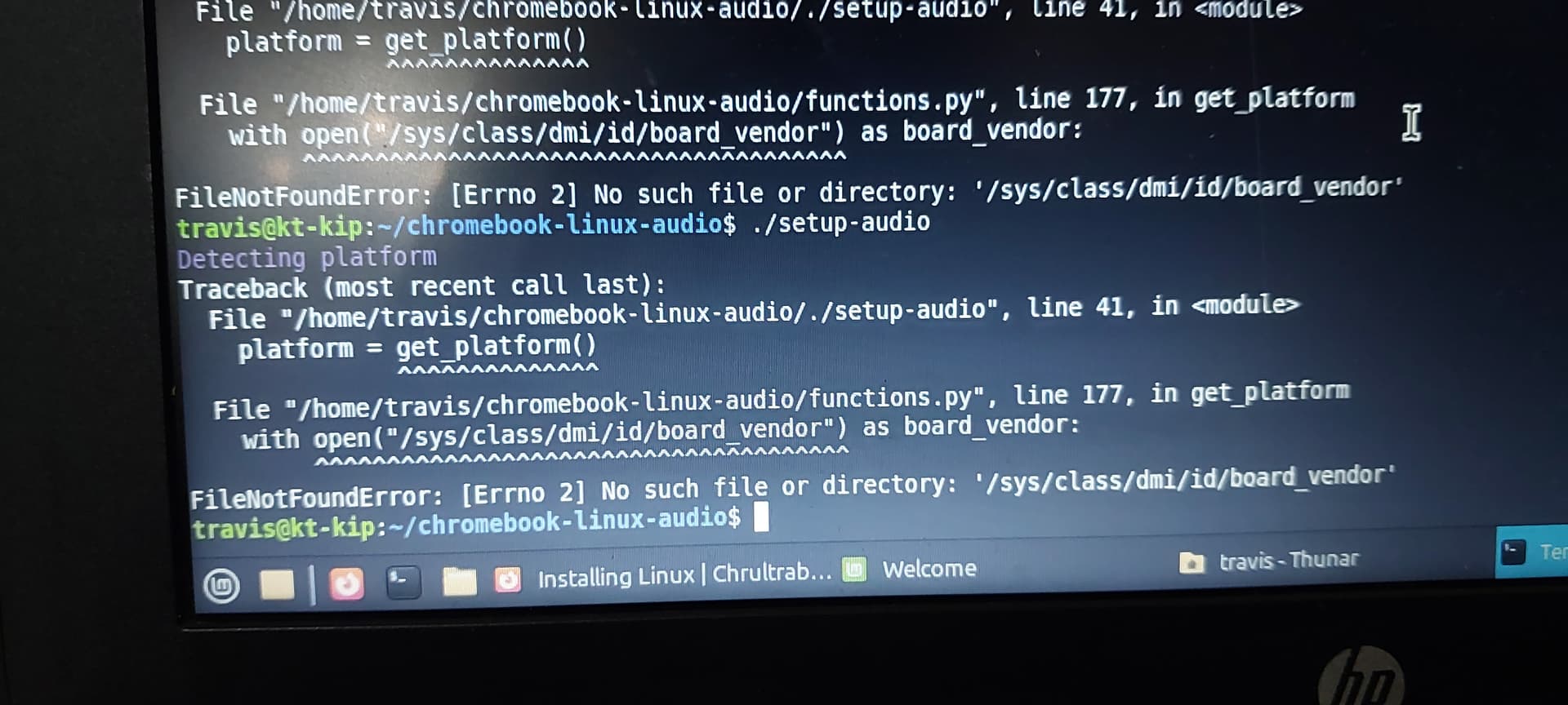

So i recently successfully installed Linux Mint XCFE to my HP Chromebook 11 G4, and now i did the audio script to get audio, however it did not work, after doing the 3rd (Last) step, the terminal showed this (image). What do I do?
the setup-audio script shouldn’t be necessary and isn’t designed for Baytrail Chromebooks AFAIK
Ah, what can I do to get audio then?
it should work out of the box, if not use the chrultrabook diag script to collect the data needed to debug the issue and post here

I do have a function for braswell/baytrail but in most cases you don’t need it
here’s the file https://www.mediafire.com/folder/fy5bzmivzvoxq/debug-kip
Ah, how may I do it? as my audio does not work, neither speaker nor aux
