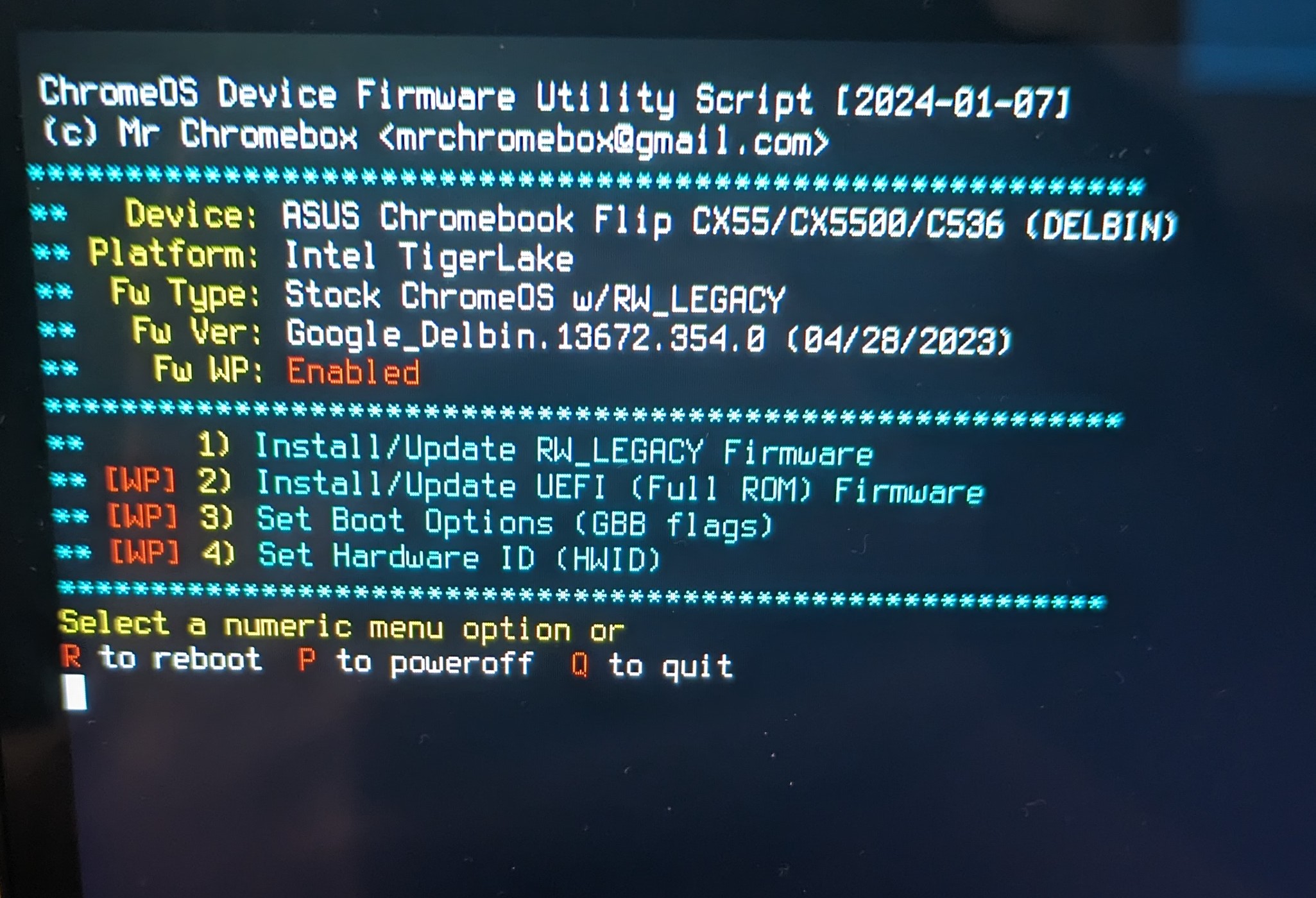

Update: I entered developer mode, then unplugged the battery, with it unplugged tried to use the mrchromebox firmware util from developer console, but this tells me the device still has Firmware WP enabled.
Triple checked already that my device has cr50 wp. Not sure how to proceed from here.

Can you send a picture of the firmware util running?
Hey, here is the running firmware util.

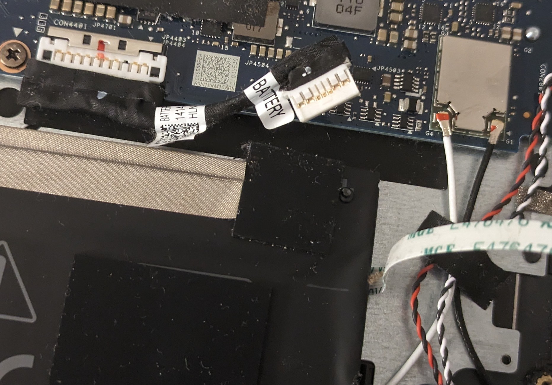

In addition, heres the disconnected battery, maybe theres something else that needs to be disconnected to disable wp?
Oh I see now. You need to disconnect the cable from the motherboard side, not the battery side.
i didnt even know you could disconnect batteries from the Battery side… - thats wild
Only on some boards.
thanks a lot, I got everything running perfectly after disconnecting the right side of the cable… :woozy_face:
