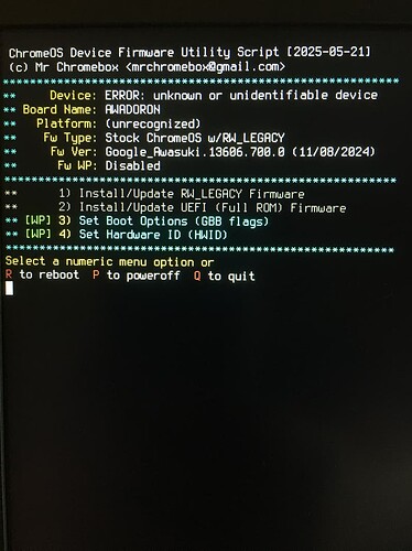

but #1 and #2 Install UEFI is greyed out , so not able to flash the firmware..

both options for RW_legacy and UEFI are greyed out

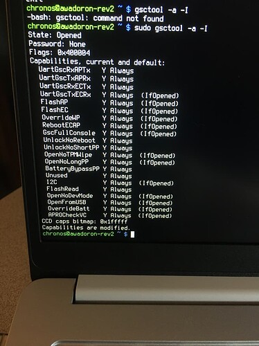

Here’s the GSC Tool information that showed good

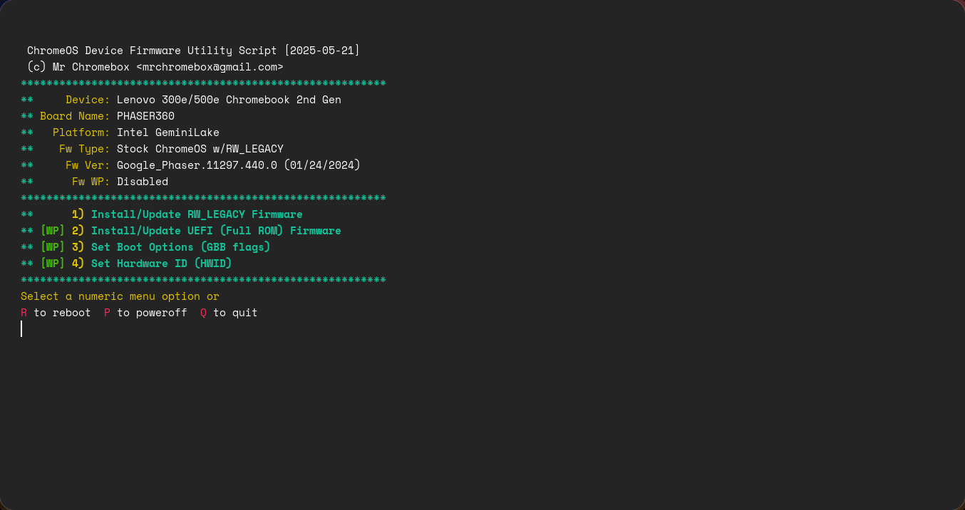

I wonder if your device isn’t supported yet, as it would usually show the device name at the top, like in this picture:
Also, the model you have is not in a series, it would know your device and show you the model name. As you can see, mine is in a series, which is the Lenovo 300e/500e. Its also the 2nd revision.

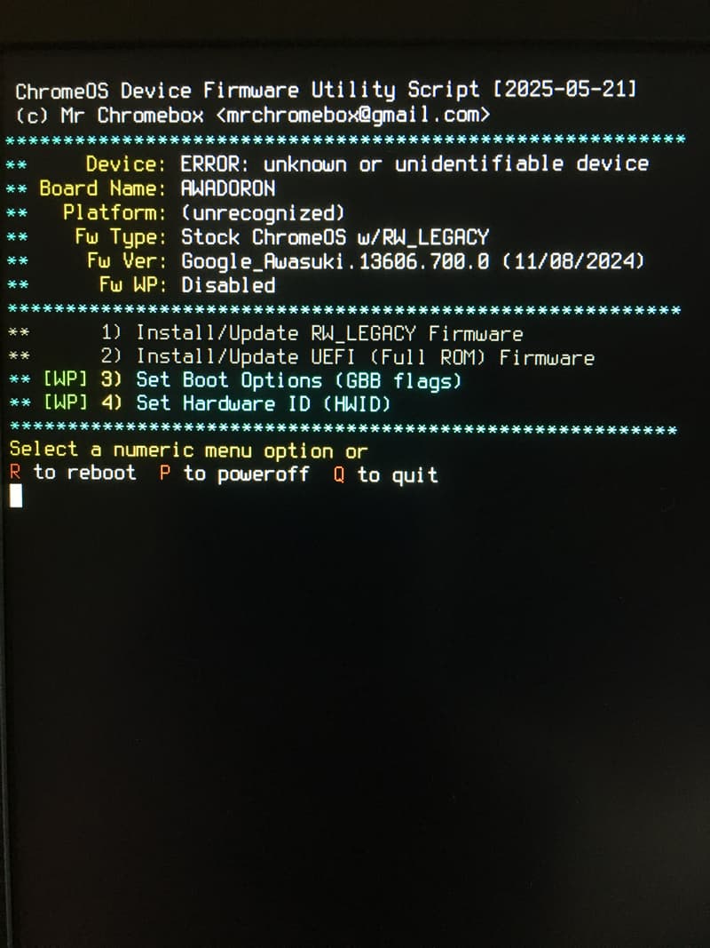

The model name has no effect on whether your device is supported. Only the board name matters. Your board name is AWADORON, which is not currently supported. You’ll just have to wait for MrChromebox to add support.
