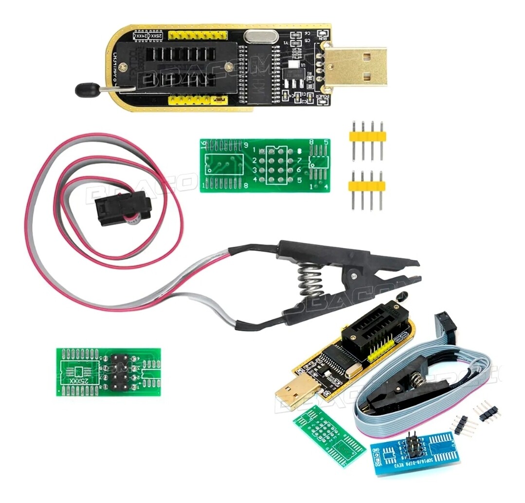

there’s zero reason to install stock ChromeOS on a device this far EOL. Just use a $10 ch341a programmer to flash the chip directly and then install Flex or whatever OS you want.

the only reason i wanted to install chromeos was to follow the tutorial to install another os. if i can use a standard bios chip programmer to do it, that’s fantastic, ill buy it asap :slight_smile:
since you mentioned that, can you redirect me to the part of your guide that covers using that? what bios to flash etc.
excuse me, is one of those enough to follow that?
yep
hello mr chromebox, my ch341a arrived and i tried reflashing the bios chip with it and ran into some trouble
it identifies the chip as “spdf capable chip” instead of showing the model, and anything i try to do results in an overflow, timeout or “programmer not initialized” error, transferring no more than 4 bits. it also says the output pins are disabled. what could he wrong here?
