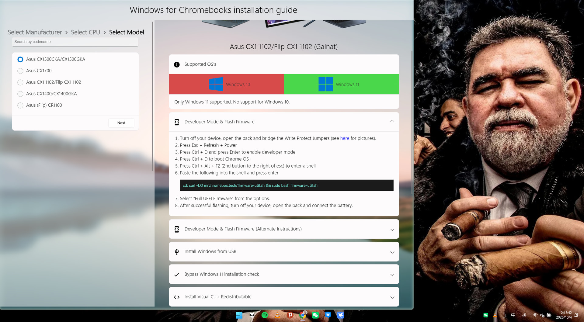

Hi MrChromebox,
Yes sorry. Should have typed my reply a bit better. I meant. After removing the battery, i cant boot into recovery mode and then the developer mode. I’m specifically following the instruction from your website
“Opening CCD with gsctool”
And the
“Disconnecting the Battery“
Sections which does say to remove the battery, flash and reconnect
So i figured i need to do this step

Your operation steps did not follow the official guidance specifications at all. The prerequisite for starting to flash the script is that the device correctly opens developer mode, opens VT2 mode, and correctly inputs the script before the device can run correctly and start flashing UEFI ROM. The official has not stated that the correct operation for unplugging the battery is to disconnect the battery and motherboard connection port, and then use a charging power cord to perform the operation.
