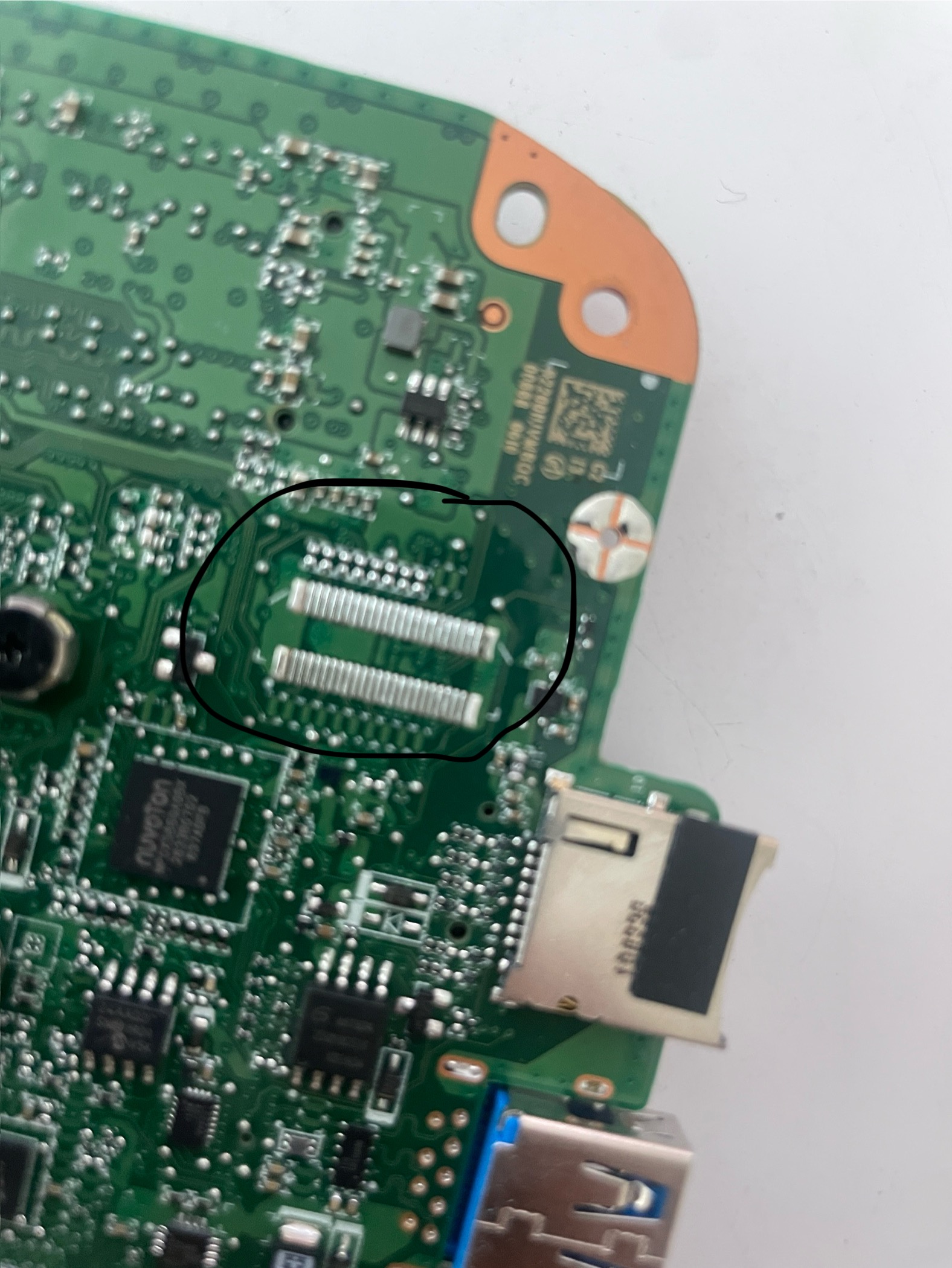

Just curious. Anybody know if this is extra pcie slot, or some other functionality that can be extended by soldering a chip here? This is behind microsd card connector on my asus chromebox 3.

That is probably the servo debug header.
this ^^
(technically it’s the pads for the servo v2 header connector, not the header itself)
