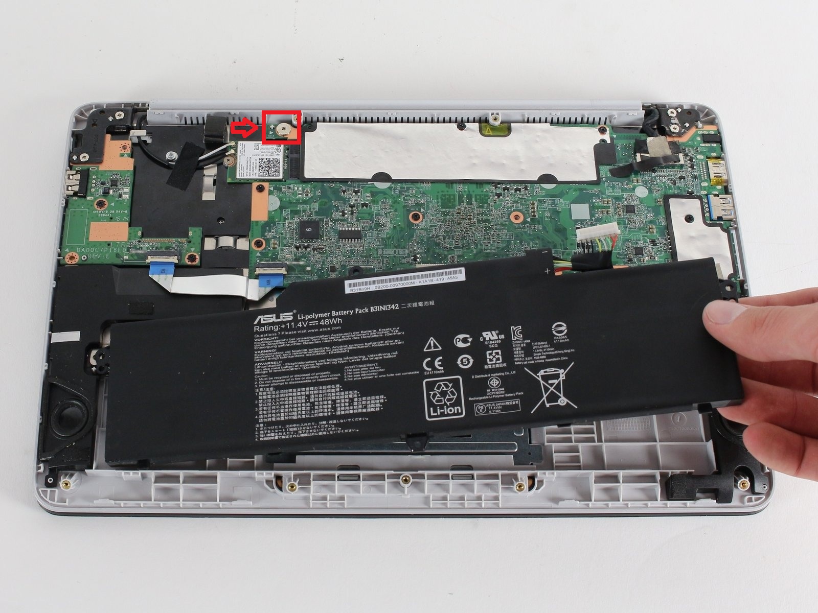

Hello @PrincePersia I have a C200 with squawks board. Do you confirm write protection is made with a screw ? If yes where it is ? I cannot find any information.
Thanks !
Hello my friend @tpam03. Yes it is secured by a screw. I have marked the place where you need to unscrew it in the picture below:
Thank you so much @PrincePersia !
I managed to flash the firmware, now time to install linux :slight_smile:
