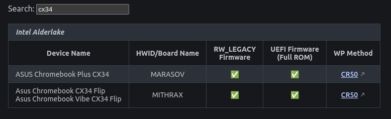

Just a bit of context below, there seems to be a discrepancy between the documentation.
The guideline from coolstar mentioned “bridge the Write Protect Jumpers” but that on the mrchromebox page indicated CX3402 as “CR50 battery” instead, not sure which one is correct
no, it doesn’t
CR50 = SuzyQ
Cheers mate, save me lots of time trying to spot the jumper on the board( which unfortunately did tbh). I will try to grab one from eBay
