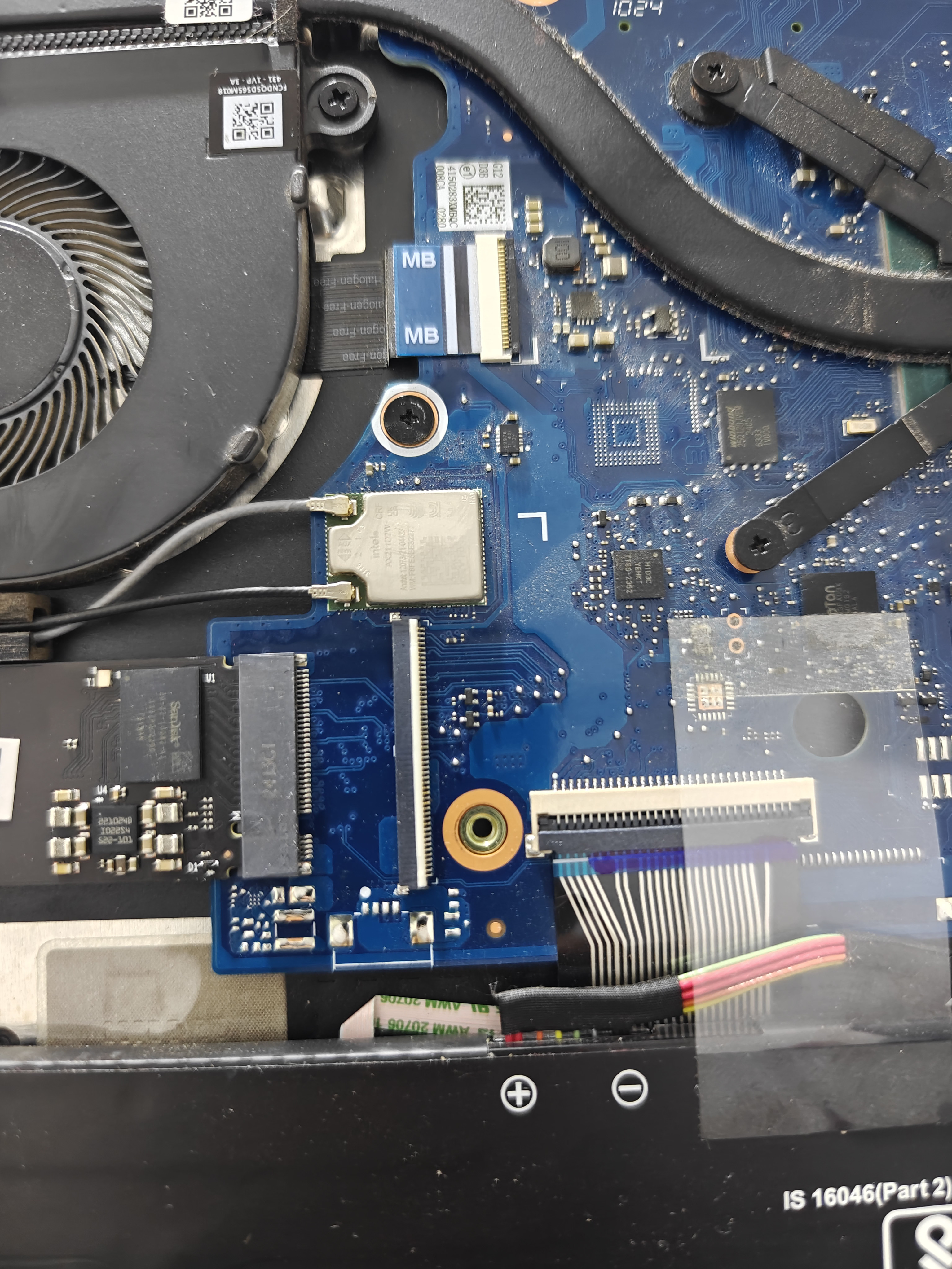

i have this chrombook when but i cannot get rid of hardware protection. i removed the battery and applied gsctool -a-o
and when i go through it and apply
gsctool -a-I allowunverfiredRo:always
it give me "error 7 (notallowed)
is there any way to solve this?

If the battery is unplugged when you run gsctool -a -o it will reboot before the assert PP step.
so i have to connect the battery and get suzyq. is that right?
You definitely need a suzyq cable. As far as the battery, I think it will still work but not positive, but there’s no reason for it not to be plugged in
i will connect it and try again. but if it fails there will be no need for the suzyqable
you absolutely need the battery connected in order to unlock the CCD using gsctool, that is 100% your issue

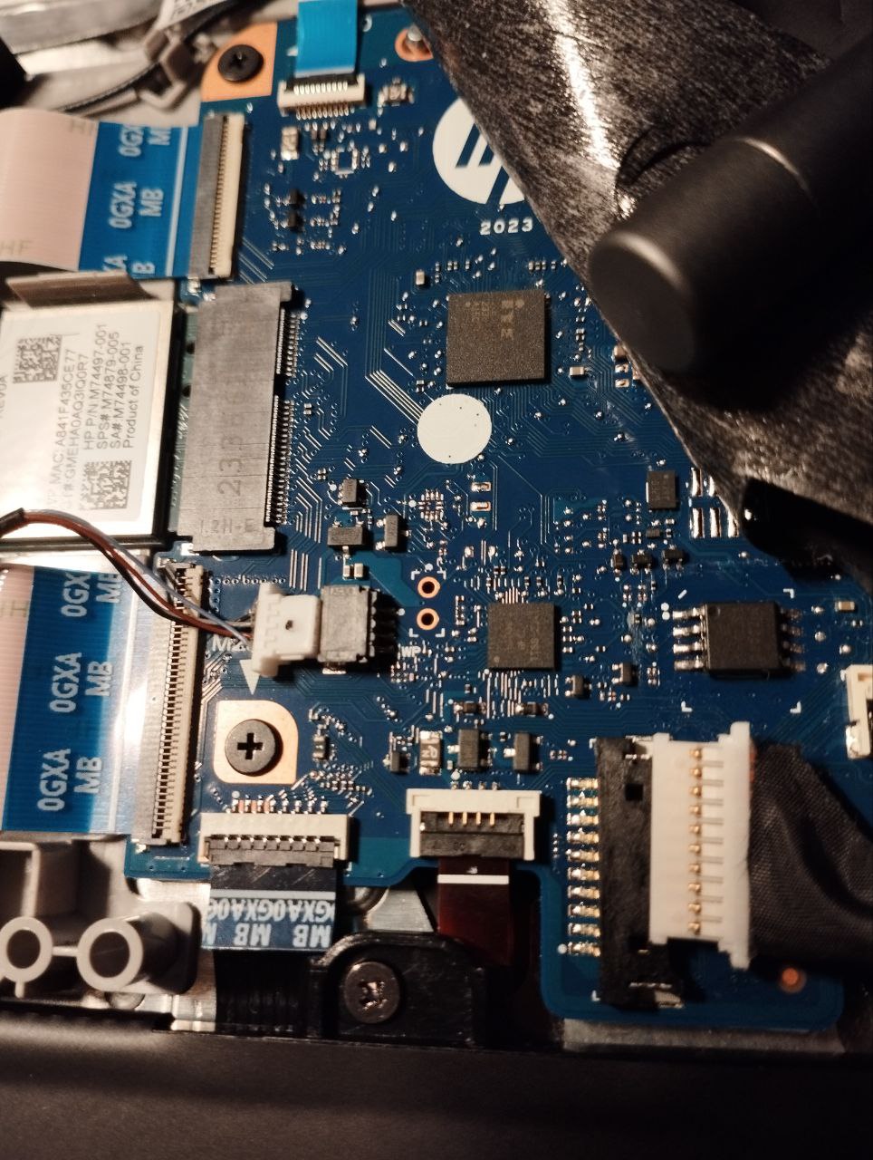

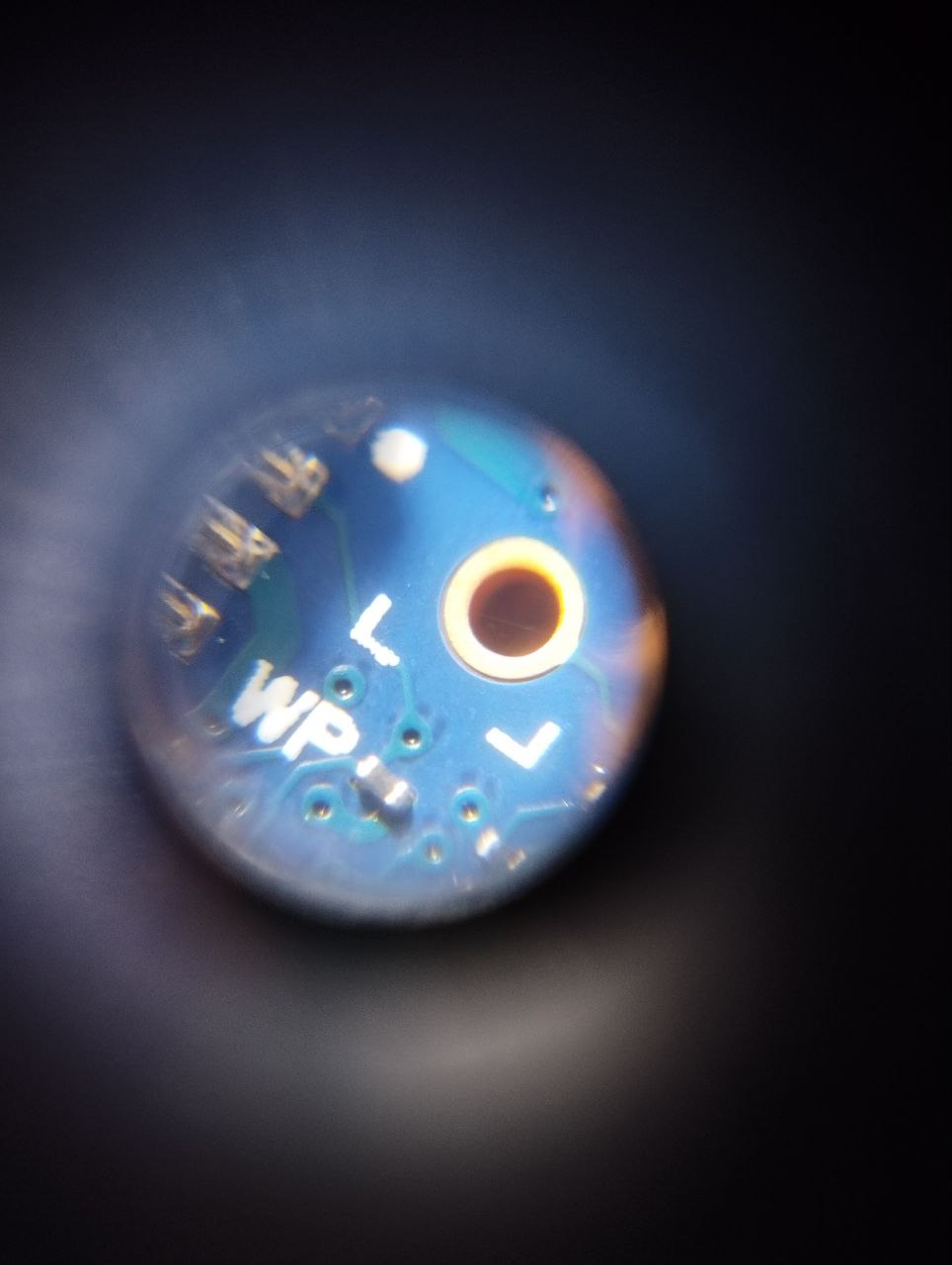

YAVIKS has a WP jumper.
I think not, it’s not his issue. I am facing the same problem with “gsctool -a -o”. It just turns off the Chromebook at step 6-8 without any output. Shorting WP jumper on the board, or disconnecting the battery, it just restarts without any output. But all results in still CCD locked.
