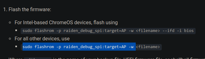

you’re using the incorrect command to reflash the backup on an AMD device:
It seems there is an issue with the latest release and some Picasso boards, but I’m unable to determine what it is. I assume you tried a hard reset (Refresh+Power) after reflashing the UEFI firmware?
For flashing the UEFI, I used sudo flashrom -p raiden_debug_spi:target=AP -w <file> command.
For flashing the the backup, I used sudo flashrom -p raiden_debug_spi:target=AP -i SI_BIOS -w <file>.
So exactly the commands listed in the docs of chrultrabook.
I have tried the hard reset; from what I understand it is Volume Up and Power in this model.
then they are wrong, which is why I linked you to my site
Refresh+Power
The command on your website is exactly the same.
I have managed to restore system with sudo flashrom -p raiden_debug_spi:target=AP (without -i SI_BIOS)
I have tried installing coreboot again, with vpd.bin applied, and nothing. I believe something is wrong with this build of coreboot, although I might be wrong.
the -i SI_BIOS is not correct, nor is it present on my site. So no, it’s not the same
Seems some PCO devices are not working properly with the latest update, no idea why, need someone with a SuzyQ to help debug since my devices work perfectly with it
