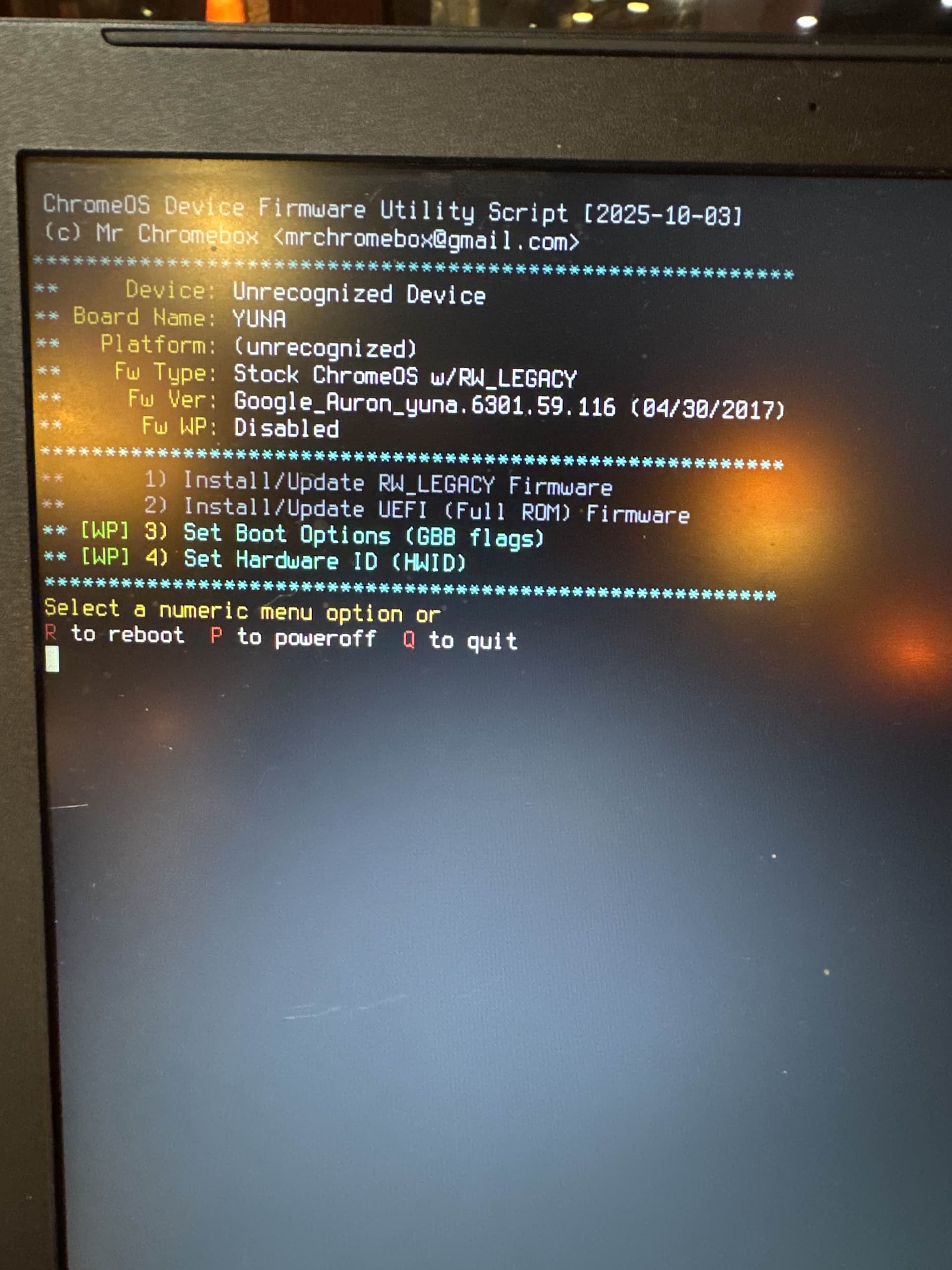

I have been attempting to enable/install UEFI on my accer chromebook15 (C910) but the Firmware script doesn’t allow me to run the UEFI install. I attached an image of what it displays when I run the script. Please let me know what logs I might need to best get help with this. The Laptop’s keyboard is a spanish keyboard and is current theory on whats causing this issue but not sure how I might be able to fix.
quit to exit, pastebin and link the file /tmp/mrchromebox_diag.txt.
YUNA is definitely a supported device. Your keyboard is irrelevant.
went to go grab that file today with a fresh run of the script and the issue fixed itself. 0 clue what changed but problem fixed itself to my perspective.
