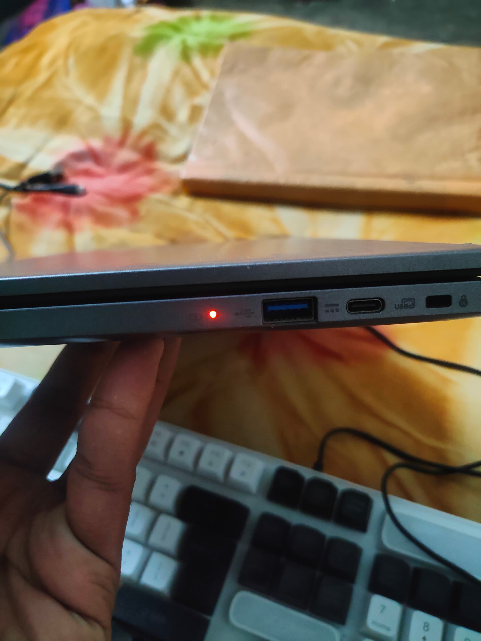

Why the indiator light is blinking
I installed windows on crassneto everything works properly but why this indicator light blinking continuously also after shutdown
From experience, that amber/red light only blinks when the battery is low, OR the battery is disconnected but the device is receiving external power from a charger and such
  1. Is the battery connected to the board properly?
  2. Have you charged your chromebook?
Its full charged and adapter disconnected still blinking
Weird… Try an EC reset? (hit refresh + power button on your keyboard at the same time and hold it for 5-6 seconds)
I don’t see any reason as to why your charge light would be blinking red otherwise.
because you need to disable fast startup (aka hibernate)
Its worked thanks sir
