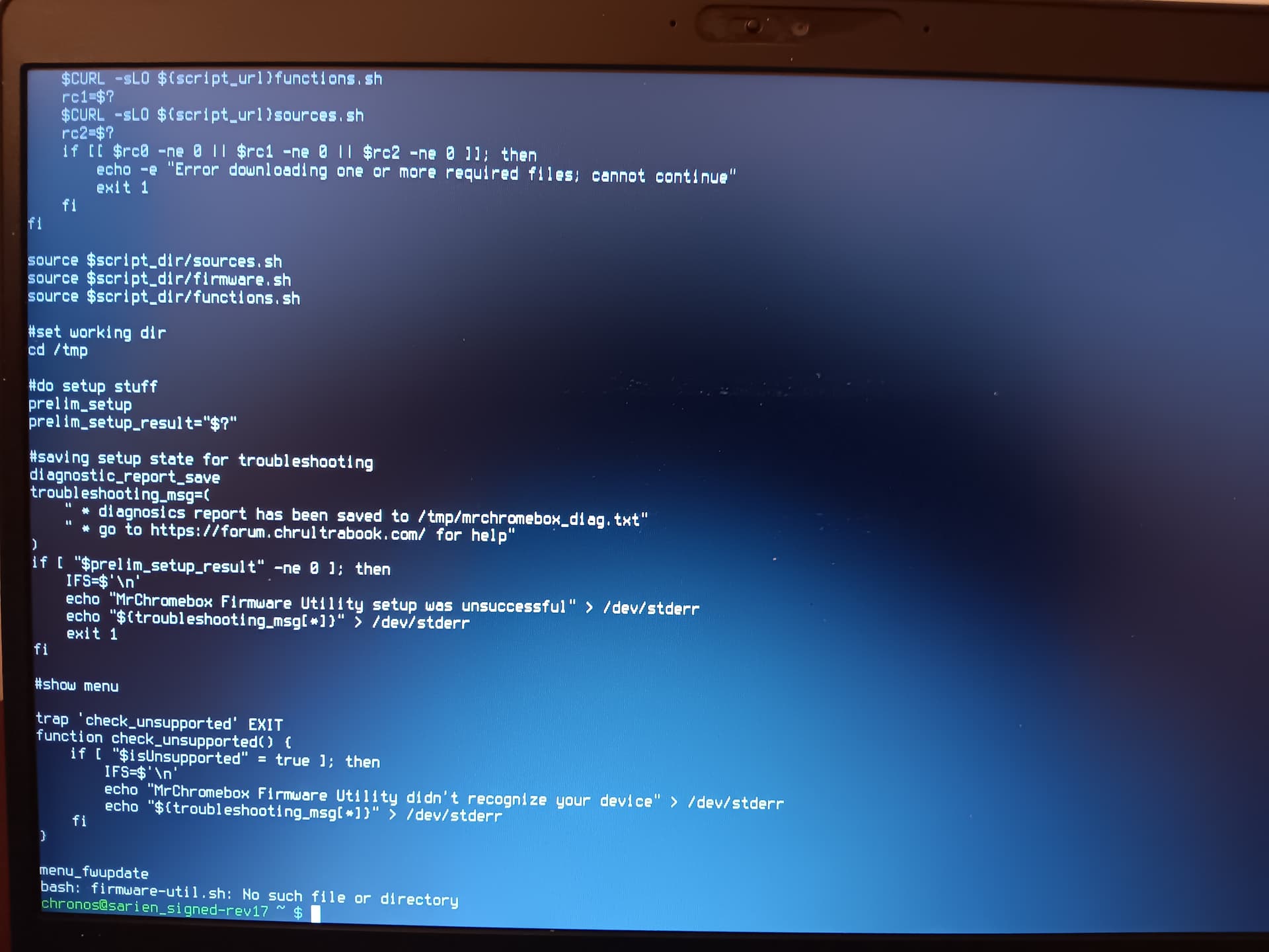

Response from FUS from MrChromeBox, I’m running Dell Latitude 5400 Chromebook. Developer Mode is enabled. Tried -LOK as well.
I think that you typed the script in wrong. Also, using -LOk is for when there is a certificate error. Try making sure you typed the script right.
I double checked and it is still making that error.

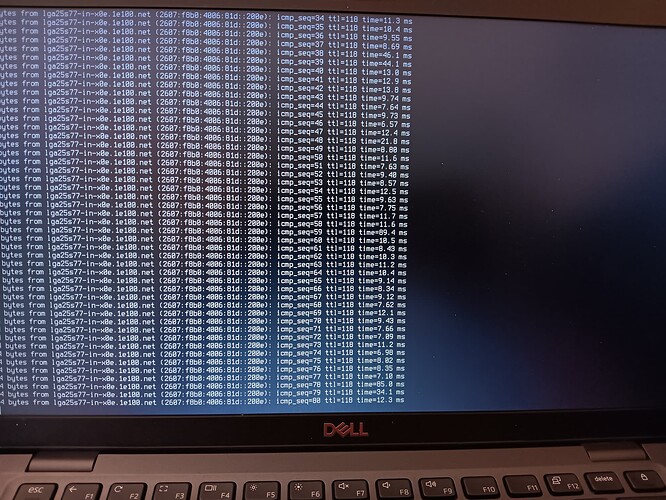

Try running “ping google.com” and post the output. I think you may have a connection problem.
Ping is fine.
I tried again, and it seemed to work.
