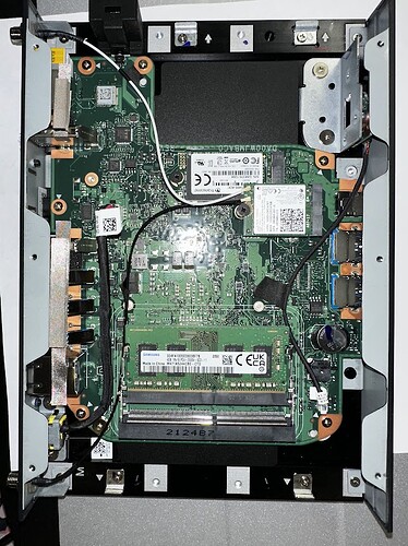

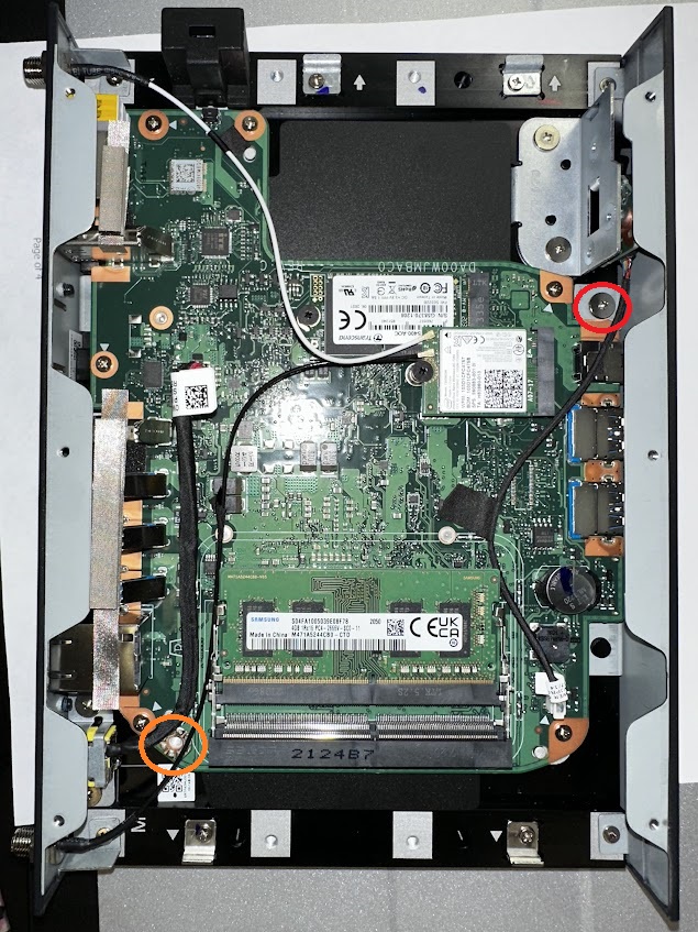

It worked!
Attached are two photos, one with the WP screw removed and (what looks like) where the screw was stored (its the one I used). The second is with the WP screw installed.
https://imgur.com/a/aopen-chromebox-commercial-2-wp-screw-XrswPkY
https://imgur.com/a/aopen-chromebox-commercial-2-wp-screw-installed-u9vYaQa
thanks, I’ve added this to the website
